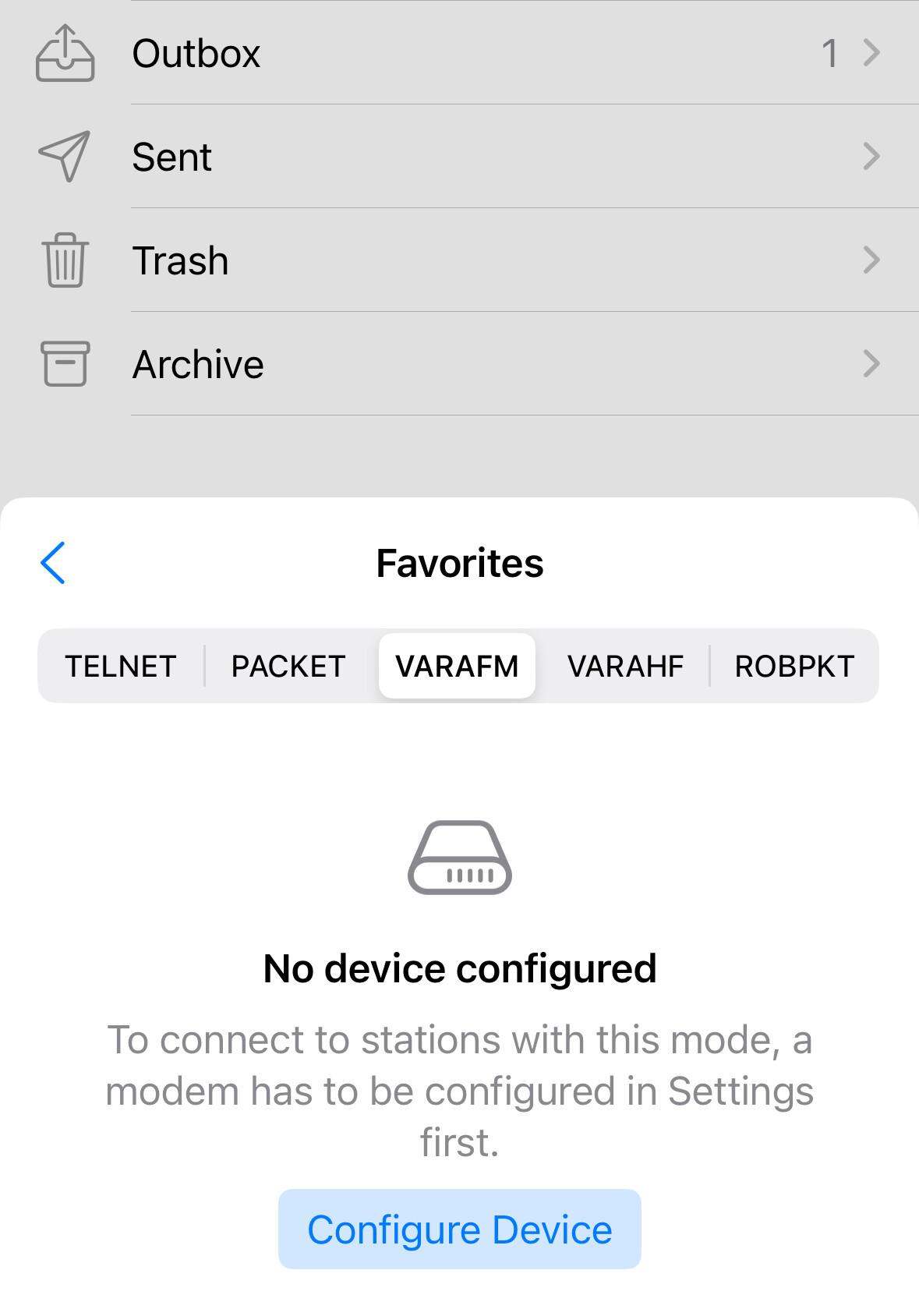

When I attempt to connect to a VARA FM gateway with RadioMail, I get the “No device configured” message as shown in my first attachment.

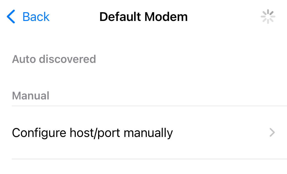

When I select ‘Configure Device’ → ‘VARA FM Modem’ → ‘Default Modem’, no modem is detected on my iPhone.
The VARA FM documentation — if I read it correctly — indicates that I need to create an external connection to my nearby laptop or some other external modem device.
I understood (wrongly?) that I had everything I needed with my iPhone, DigiRig Lite, H/T and cable adapter setup to send a RadioMail message to a VARA FM gateway through my H/T via my Digirig Lite.
Is there (hopefully) some way to manually configure my phone to see a default modem device that already exists within my iPhone?

there is no way to ‘do VARA’ with just an android/ios device + interface + radio.
you can connect to a packet gateway though. both platforms have 1200 baud software modems in their respective winlink clients.
VARA FM, VARA HF and VARA SAT are software modems that run on computers capable of running a Windows binary/program.
so what that means is, any smartphone app that mentions using VARA, does so by connecting to a computer running the windows binary which in turn is connected to a radio.
there is no built-in/internal VARA modem for any android/ios device.

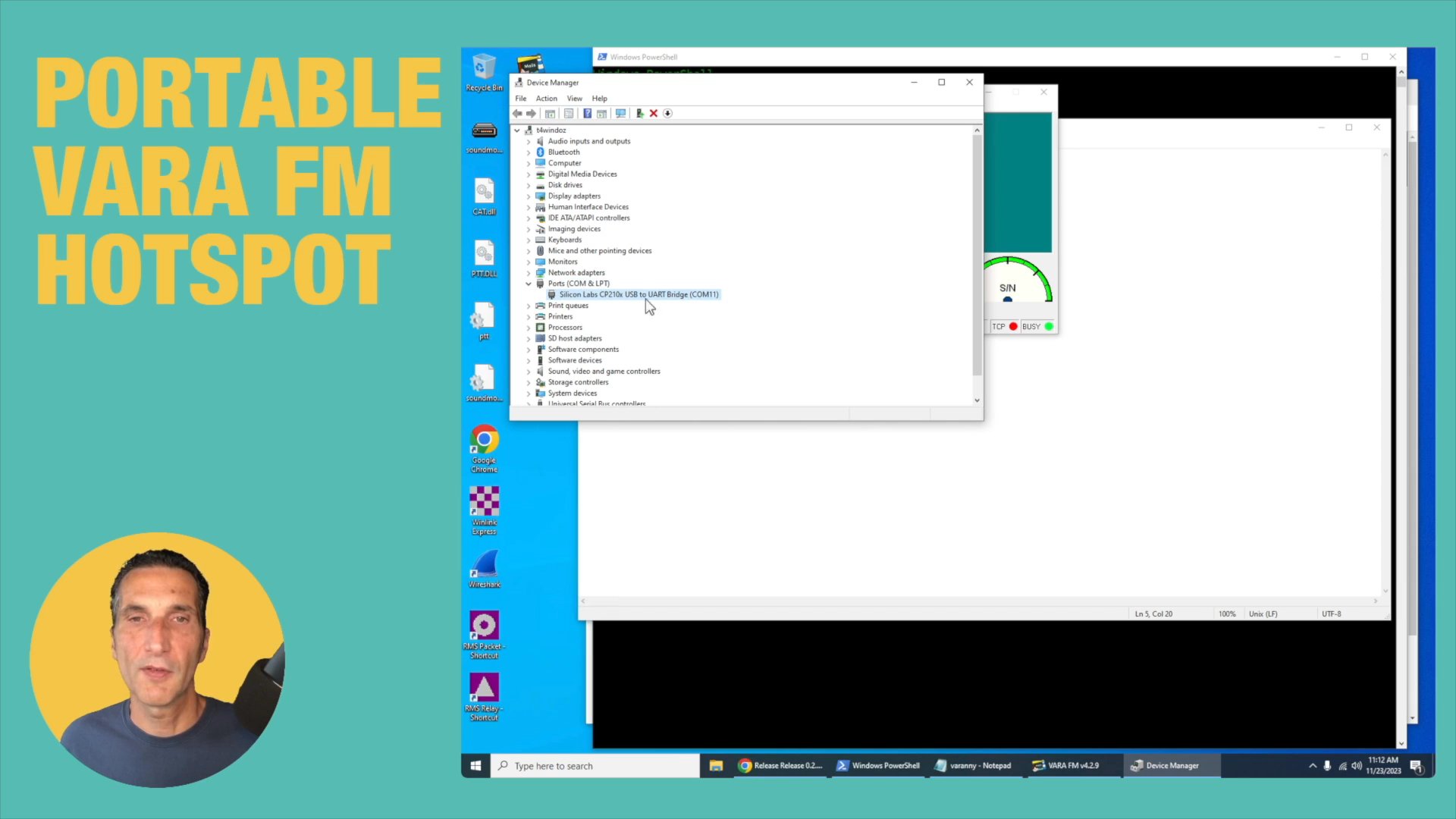

If you’re looking for the least painful way to use VARA with RadioMail, check out this video:
I walk through how to set up a VARA FM hotspot on a low-cost, headless mini computer, and how to control it remotely using RadioMail.
