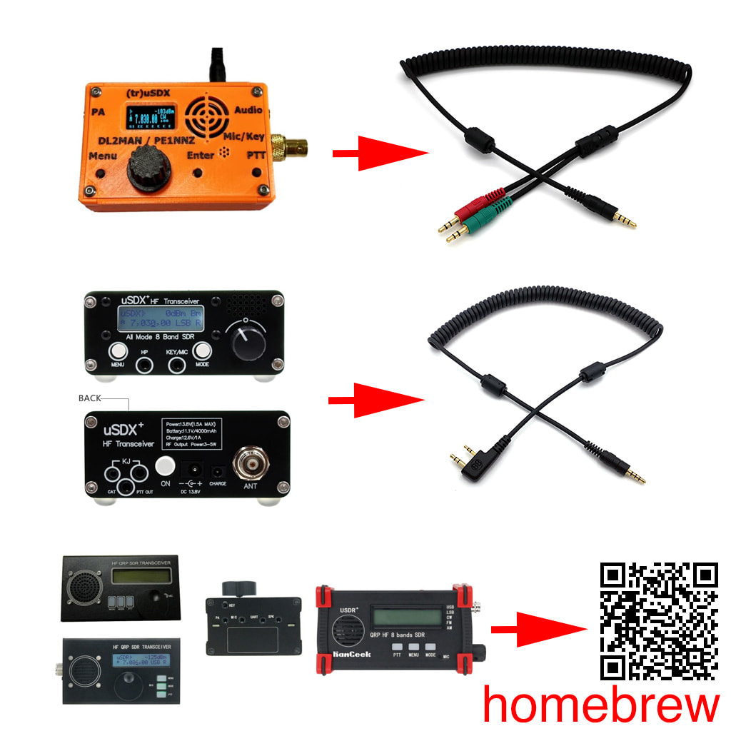

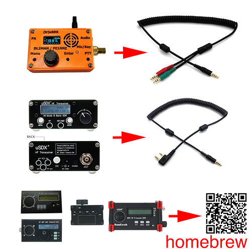

USDX cable offered in Digirig store is not a correct option for your transceiver. Please refer to the product page for the cable recommendations:
Excellent! Can’t believe I missed this in the excitement to get going on HF..coulda saved 24 bucks.
Looking thru the usdx threads, I’m going to aim to do a homebrew cable using block connectors from amazon if I can, otherwise I’ll try to cannibalize the mic cable that came with it since that seems to work.
