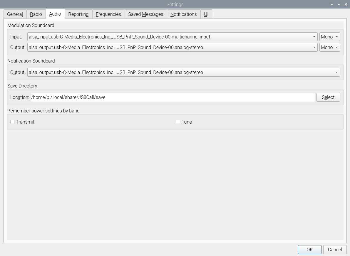

I’m using my Digirig with a raspberry pi using Build a Pi by KM4ACK. My radio is a Xiegu G90.
I’m using FLRIG with CAT to control the G90.
Wsjtx is working fine on both transmit and receive using both FT8 and WSPR.
JS8Call is receiving fine but will not transmit. It’s like PTT is not working because the radio does not start stansmitting. JS8Call says it’s transmitting but the radio isn’t transmitting.
