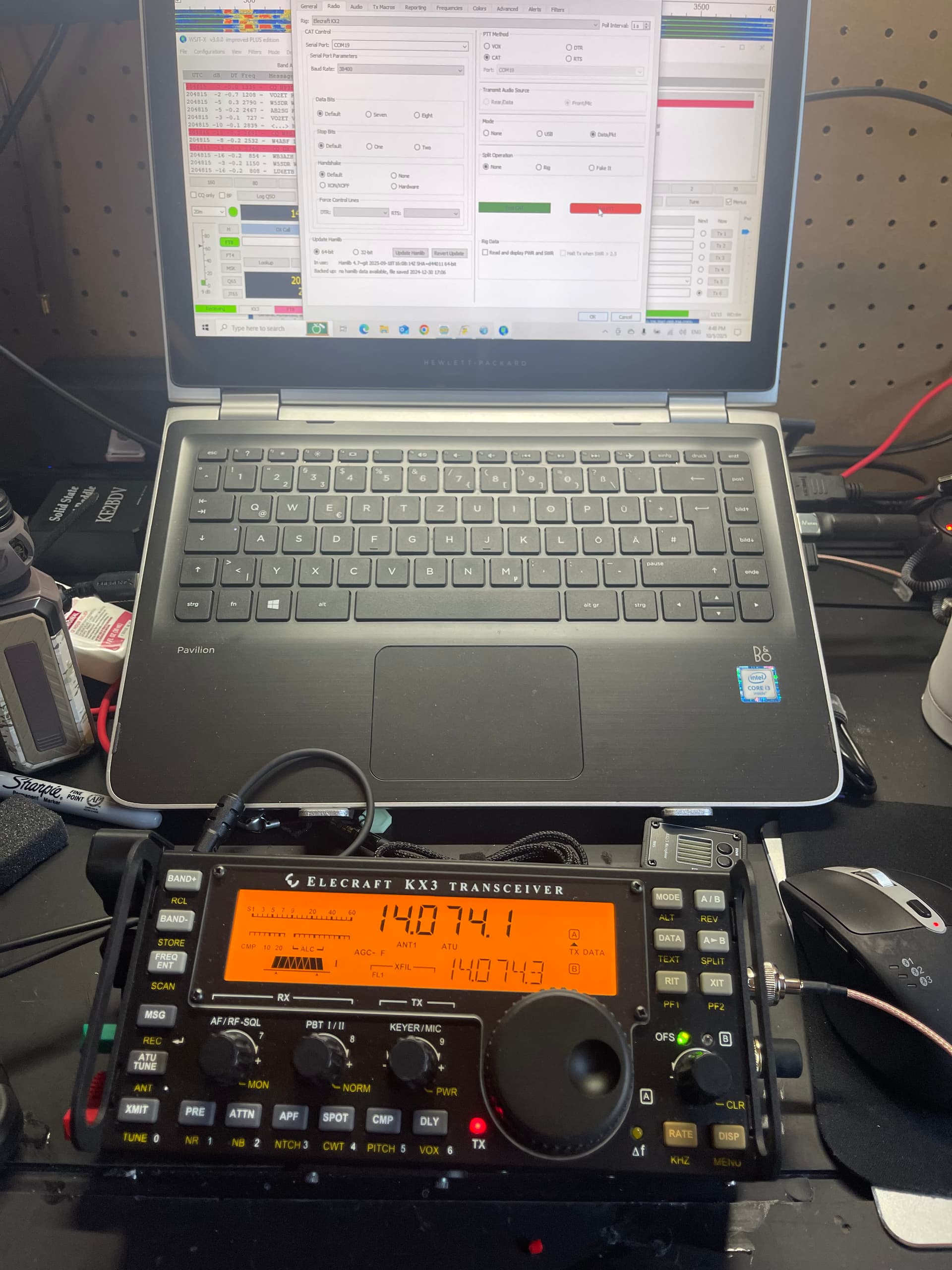

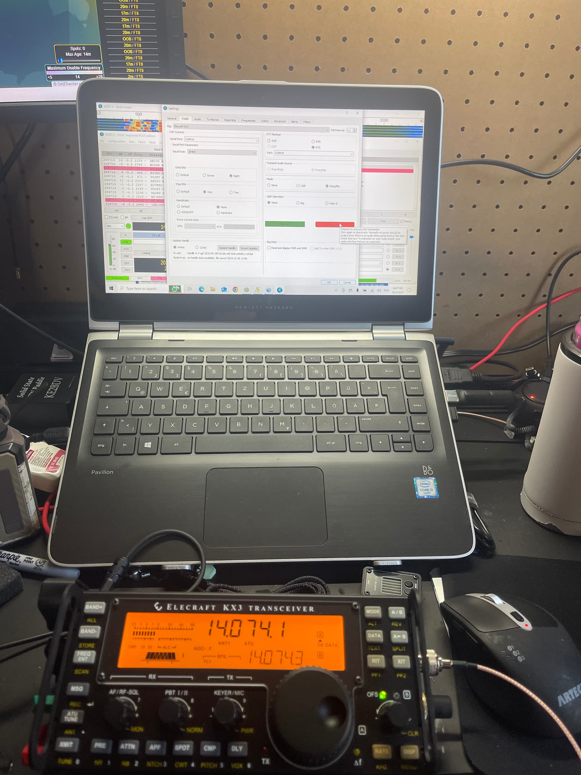

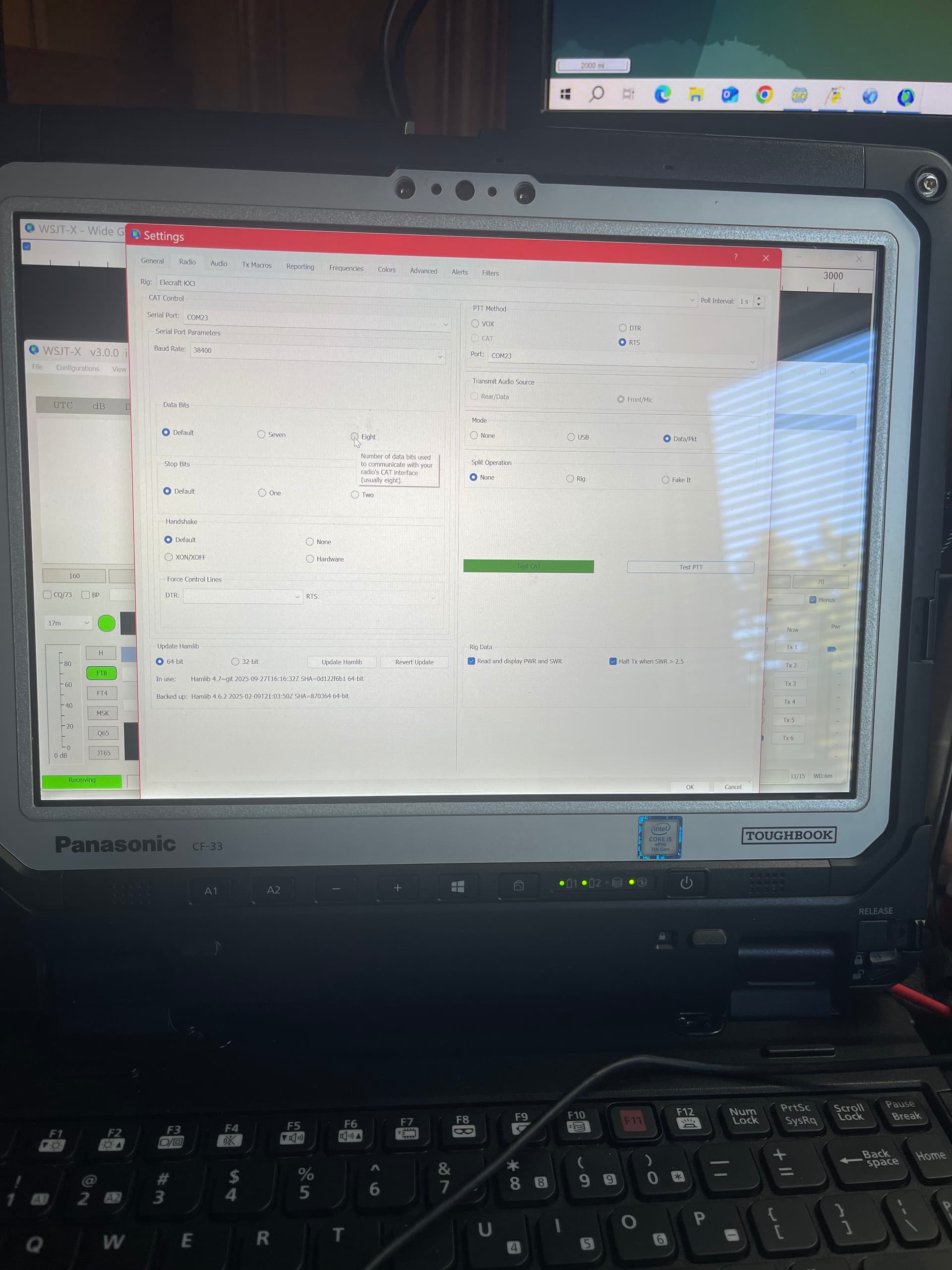

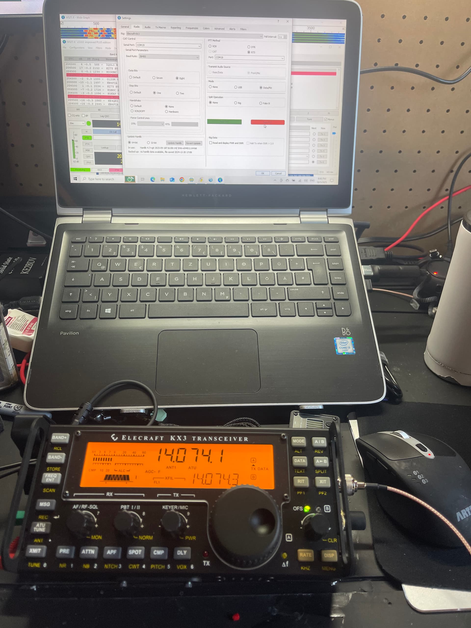

I too am having issues with PTT control. Using two windows computer (tried both)
I’ve tried all the above settings and have enough control to switch bands and receive but no PTT or the ability to tune. “CAT” cannot be selected. I was able to select “CAT” however it somehow stop and become greyed out. I select “RTS” but nothing either. The only way I can select “CAT” is if i select the KX2 as the radio. I have it somewhat working underneath KX2 as the radio. I’ll include some pictures but what I would like is a list of settings on both radio and wsjt-x or a video. My searches haven’t really lead me to anything besides partial answers and partial answers. Is there anything comprehensive out there?
