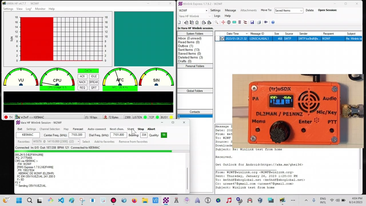

The usb only option unlocks some really cool features, like seeing the wattage output and SWR, but it just isnt stable enough yet I dont think. And its currently not being supported by them for that reason. The cat control driver even drops out when using a digirig too, but seemingly less often. I think I might try to figure out some settings to bypass CAT and just trigger PTT with the digirig. I can set the frequency by hand if it means greater reliability.
Hey I know this is an old thread now, but I put my settings for using the digirig with a trusdx at the end of this video:
