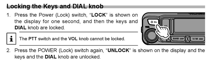

google found this section of the manual:
Yes, this works for me.
Thank you for the speedy reply! Oddly my “Advanced manual” doesn’t address this at all, so I’ll have to look for another manual. However. Pressing and holding the power button only shuts the radio down without disabling the LOCK. Pressing the button for a shorter time also failed to disable LOCK. More ideas?
Eureka! Not only did I find the correct manual, but I realized the power button just needed to be tapped, which unlocked my radio. Again, thanks a bunch for the help.
