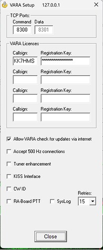

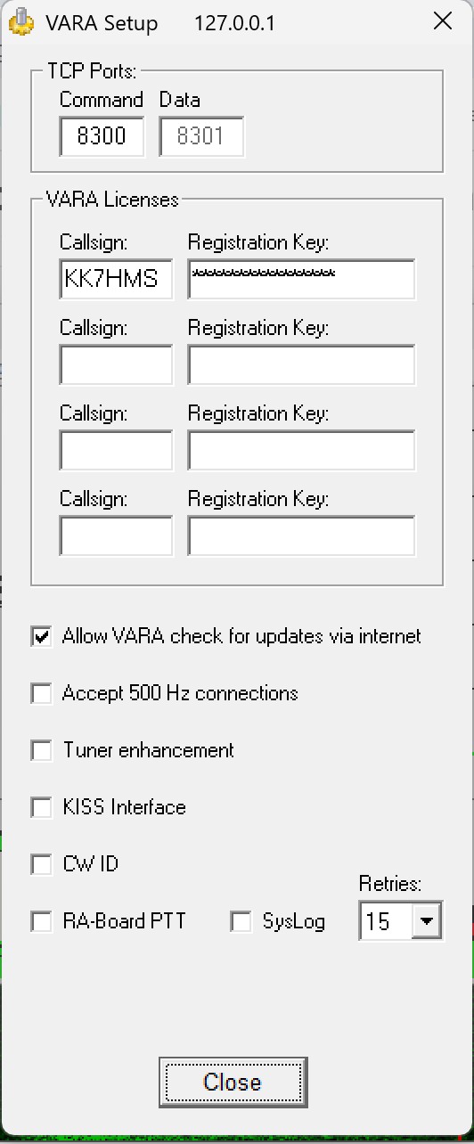

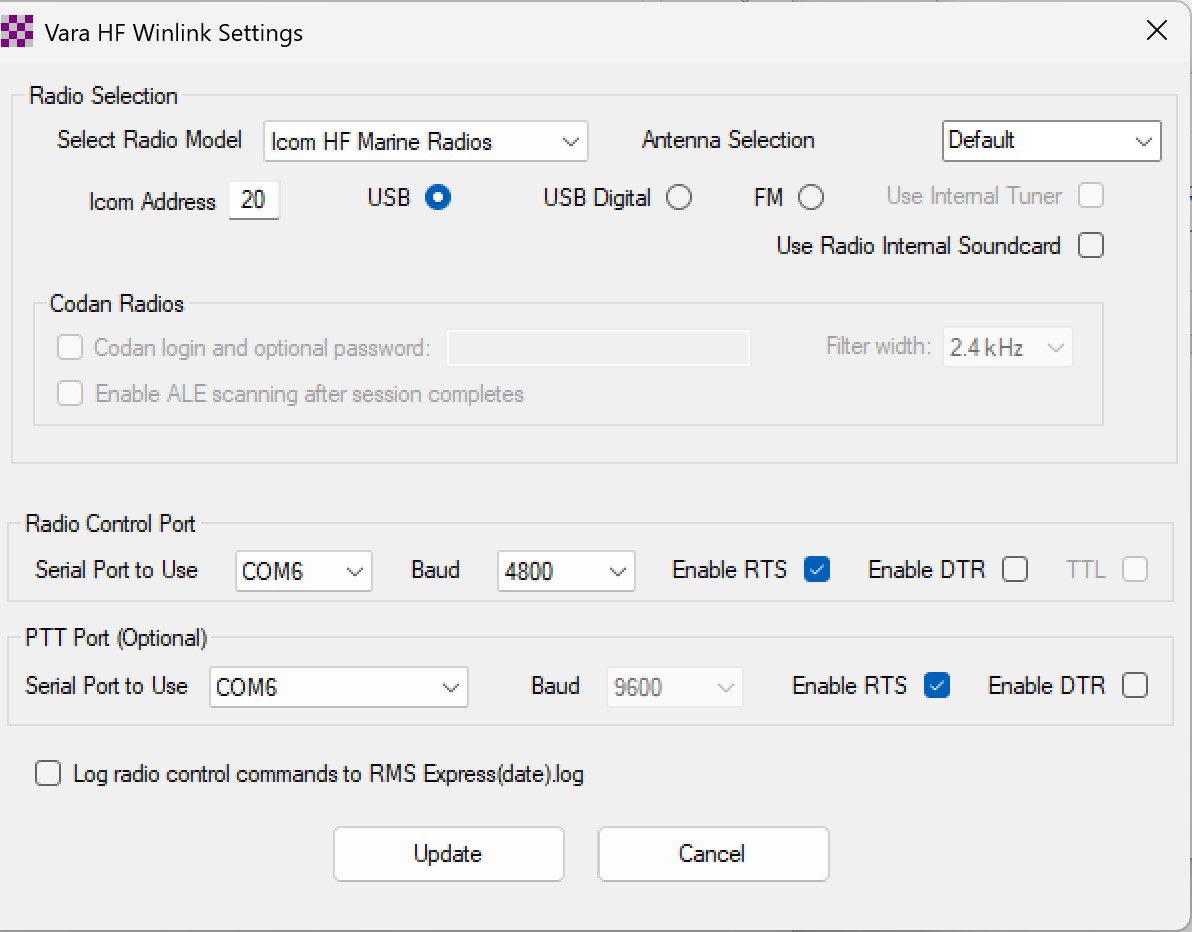

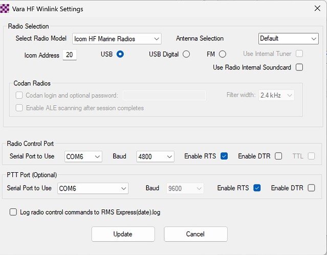

I have tried just about everything. I have included a screen grab of the lastest attempt. I am using Digirig Mobile and all Digirig branded cables. The setup works fine on other software programs.
And in the VARA HF software….I have this.
RTS should not be checked under the radio control settings, just the ptt settings
i have KISS interface checked in vara hf settings

The PTT is not working to the radio so no TX or no Test Tones. The receive audio from radio to VARA HF is working and rig control from Winlink is working through the Digirig. I will try KISS and uncheck RTS.
Harley
KK7HMS
I moved to KISS and all is working now along with some other Radio Setting changes in Winlink/VARA HF settings.
