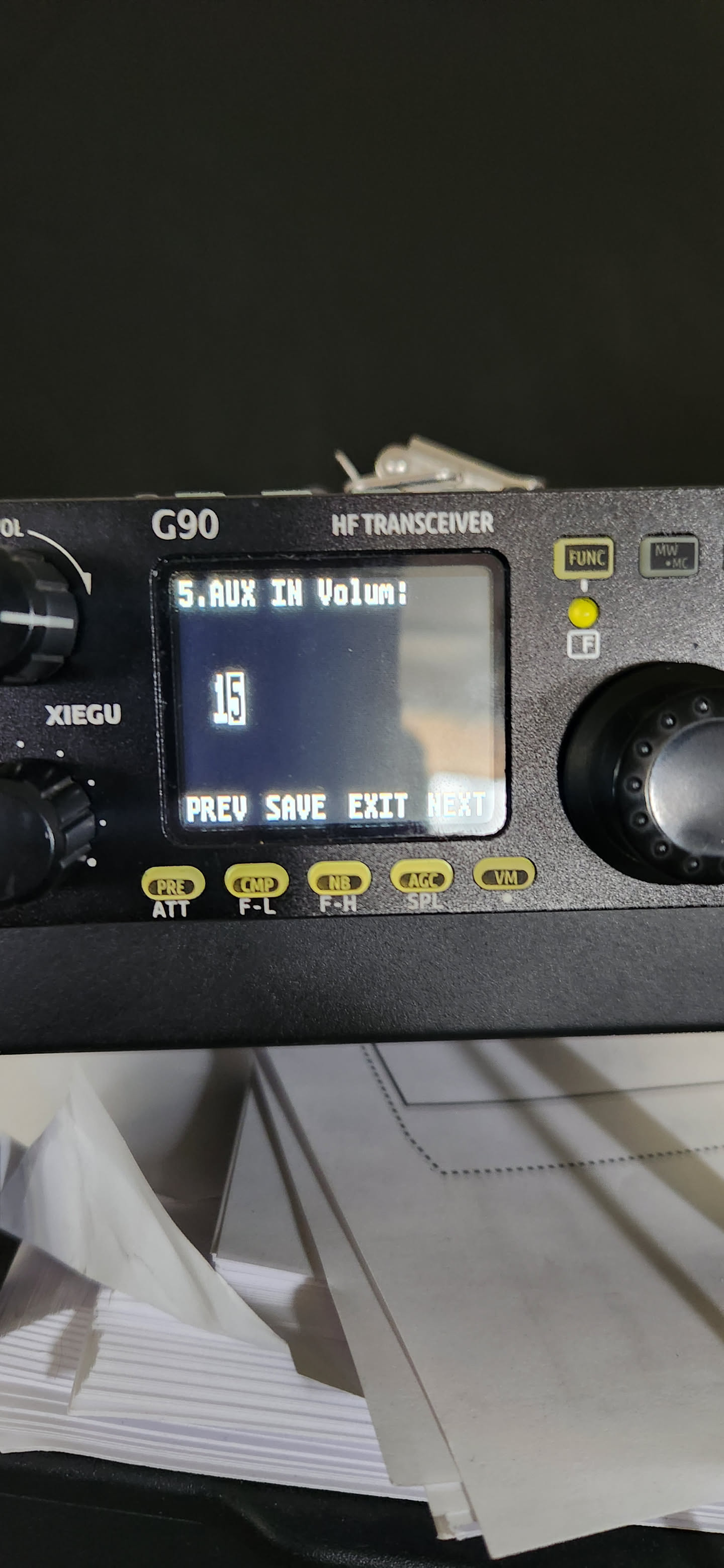

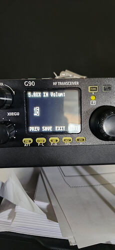

Hi webmonkey,
Unfortunately, that doesn’t seem to be the issue.
