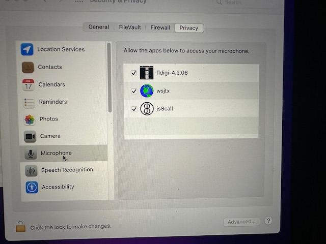

Got a report of Digirig’s incoming audio not working on Mac computer. The solution was to give apps permission to access microphone in Security & Privacy settings.
Something to keep in mind in the process of the setup and troubleshooting on macOS.
