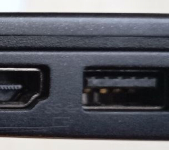

I saw on the Lenovo laptop the USB port has a « power logo », is it dangerous for the DigiRig mobile ?
Ben
See this picture
I wouldn’t worry about it. Digirig will only take as much power as it needs.
