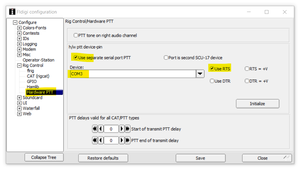

In fldigi configure PTT by RTS under hardware PTT section, not flrig or rigcat sections.
Please share the screenshots of the configuration if you continue having difficulties.
I’m not sure what I was doing wrong but it works now. Thank you for your help.
