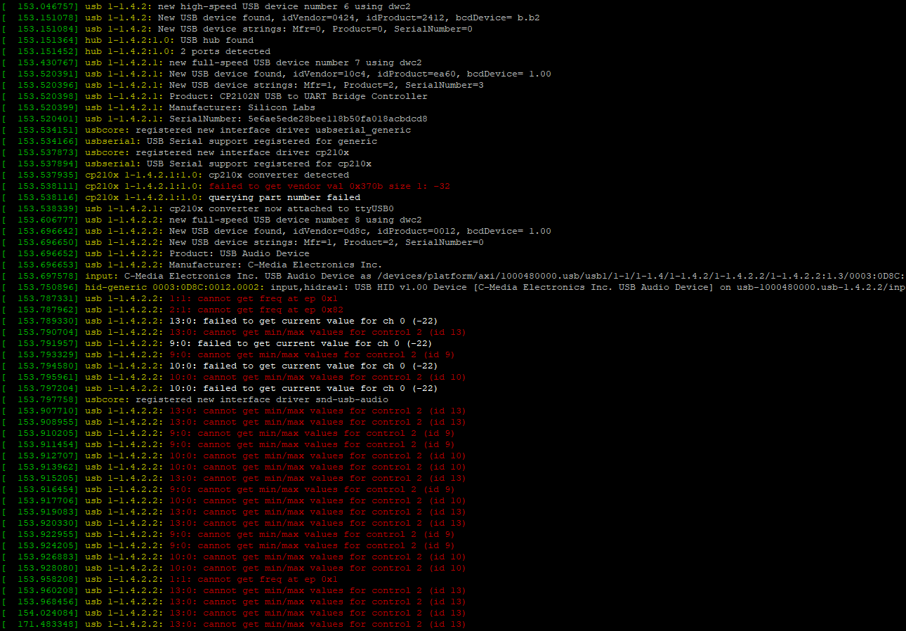

I checked dmesg to see exactly what is going on and I’m met with a number of errors:
This has me kind of stumped. The only recent update I did that I think might possibly affect things is going from kernel 6.12.32 to 6.12.34?
