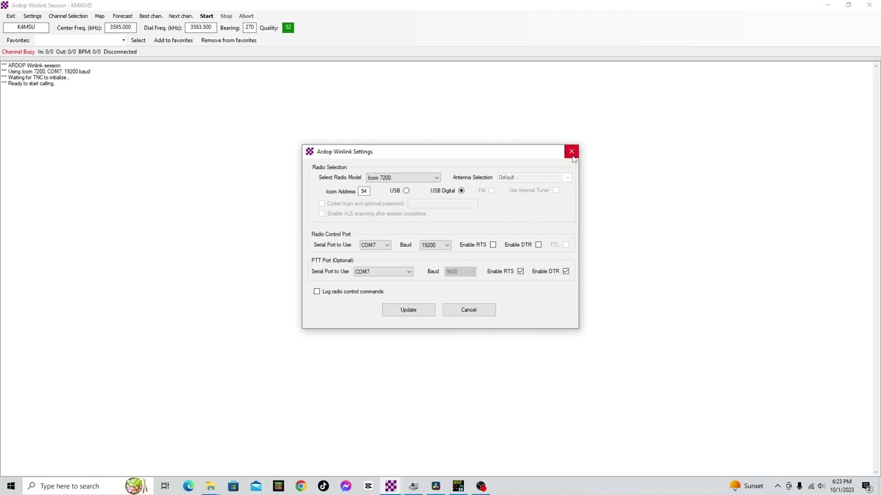

See if this video helps:
It’s for Windows, but you can do test that first to make sure everything works correctly before moving to Linux.
Everything works perfect on windows. Unfortunately I am still at a loss for linux as there is no UI and all the settings are in command line.
