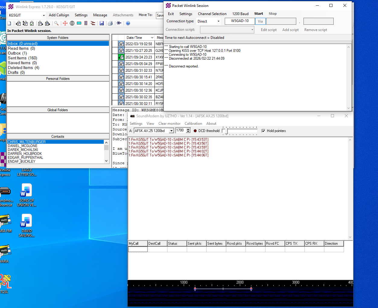

I have had a Yaesu FT2800M with the Digirig cable. It worked flawlessly for FM Packet for a year or more. All the sudden it stopped connecting. I have been down hours long Youtube and AI help. Literally hours, actually multiple days. I can not get it to work. I have verified the station works as I used an HT and Mobilnkd I can send and receive at will. Additionally I listen on frequency with an HT I can hear my packets going out and I hear the station replying but it always ends with five attempts and then Disconnect Reported. I don’t even know what to do now, I am at the point of giving up. The inital Digirig set up seemed so easy. I need any help I can get.
I use soundmodem, which prints out the dialog and signal quality between the two radios. If there are errors, I think it prints out as well. Are you trying to send messages with Vara FM packet mode, or create a terminal session?
I use UZ7HO Soundmodem, with the Winlink Express software. I amy trying to send Packet Winlink.
Are there any error messages in the packet dialog which soundmodem displays? How is the signal quality +++, +±, etc?
I get this back every time…
have you changed the squelch or volume?
you can hear the dx station on an ht but not on the ft2800m ?
or can you hear the dx station on the ft2800m ‘speaker’ but not decode the dx station in the soundmodem/winlink setup ?
Webmonkey offers good advice. There is also https://digirig.net/troubleshooting-digital-modes/ . You need to isolate and test each part of your setup.
The traffic decodes do not show any distant station signals decoded by your soundmodem software TNC.
Thanks for the advice. Like you are saying I am starting to think soemwhere in my system it is not hearing the station replying. Yes while sending I have an HT at my station I can hear when my Radio transmits packets, and then I hear packets in reply. When the Digirig is connected i can’t hear anything out the speakers as the speaker output connects to the Digirig cables, but I listen on the HT. I wish there was a step by step instruction someplace. The instructions are spread around and with diffrent rigs and setups. Should my Squelch be open? I am confused about that, the squelch and radio volume is the only thing that seems to affect the waterfall in SoundModen. I have adjusted so much I dont know where to start at this point. Whats crazy is the first set up I had no issues. I was forced to take down my shack for a while, when I set it all back up things went bad. I am going to try again today to try and bring it back to life!
