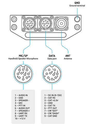

It hast GX-16 plugs instead of GX-12 an a slightly different pin layout.
Would be great if cables would be available. I guess @OH8STN has a need for cables too :slight_smile:

I guess they changed the jacks because of the new layout. All two jacks on the same side of the radio. If such cables will go to production, it would be nice to have a 3.5mm jack for speaker too. See the attached pin layout of the TX-500MP.
73, Stephan

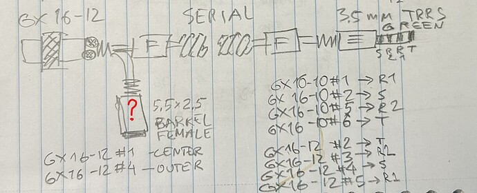

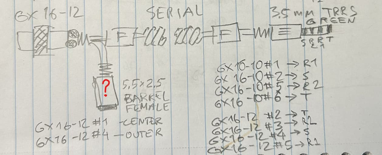

What are the thoughts on DC input via Data port while interface cable is connected?
This increases complexity and cost, but may be justified.
[EDIT]: in the above picture GX16-12 should be GX16-9. Updated drawing later in the thread.
