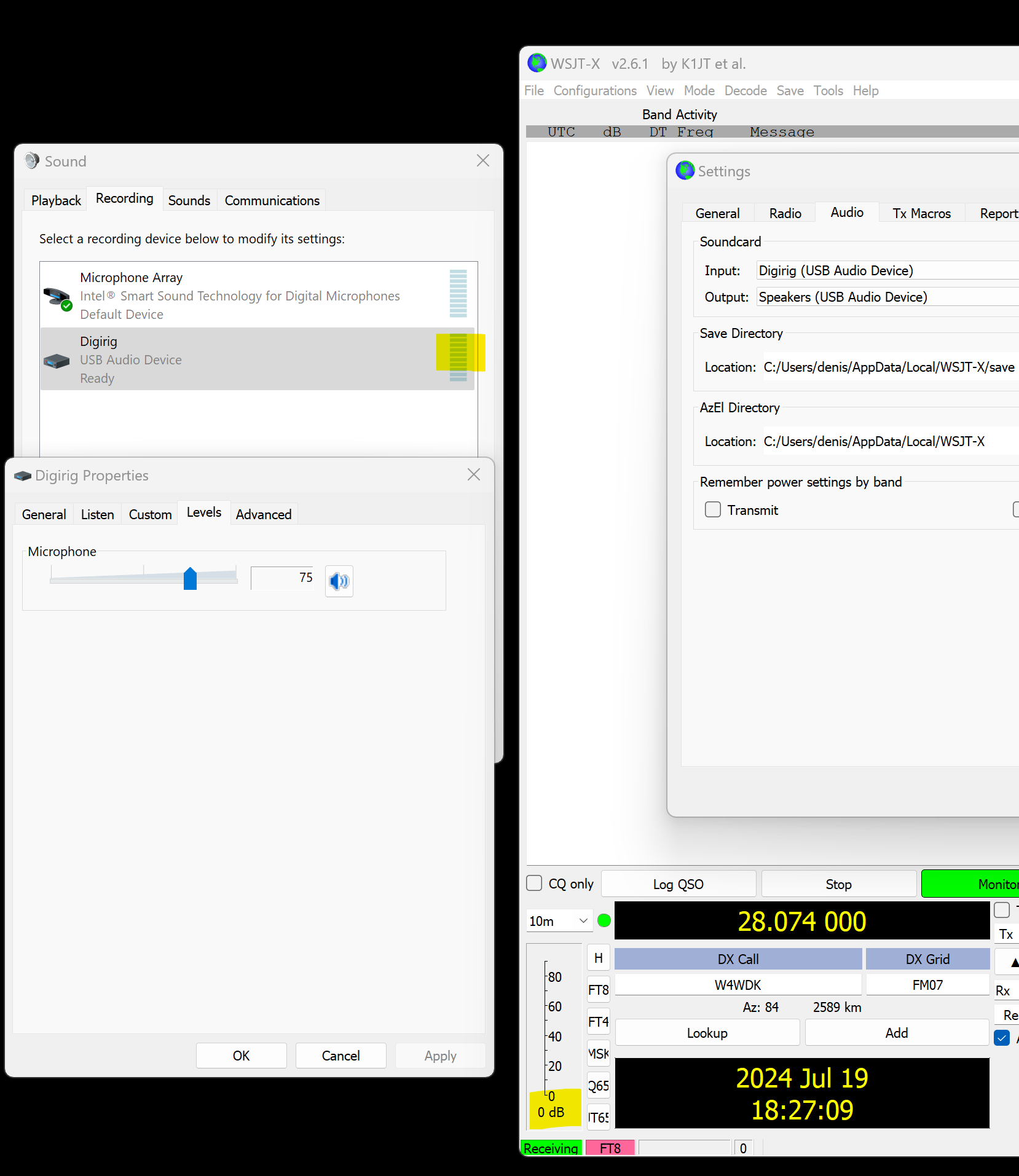

I’m travelling through the end of the month and don’t have W10 with me, but I have W11 and Digirig with Attenuator not activated. With nothing connected and sensitivity at 75 I get nothing on the level indicator. With sensitivity 100 it picks up single decibels.

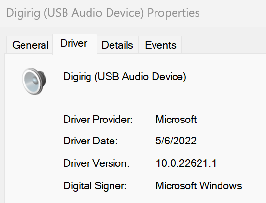

Here’s driver info:

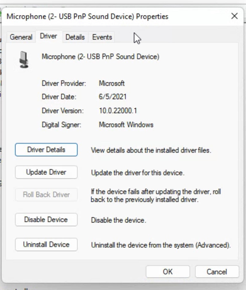

Well, when I posted this screenshot previously, you said it was fine. Windows update does not find a newer driver but clearly yours is newer/different
The second one is my W11 machine
Sorry - I forgot you said W11. But it is newer than my W11 and mine has the same problem.
I didn’t do anything special for the driver. That’s what my system (Dell XPS15) came with.
You can attempt windows update to see if newer version of the driver is offered.

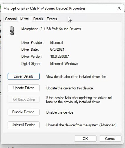

OK. I finally beat on the W11 machine and got it to update to the same driver as yours. That’s the good news.
The bad news is there’s no change. With the input at 0, there’s still about 5 db of noise with nothing connected, and with the AF from the radio connected, it’s about 60 db.
The v1.6 is unchanged as well.
