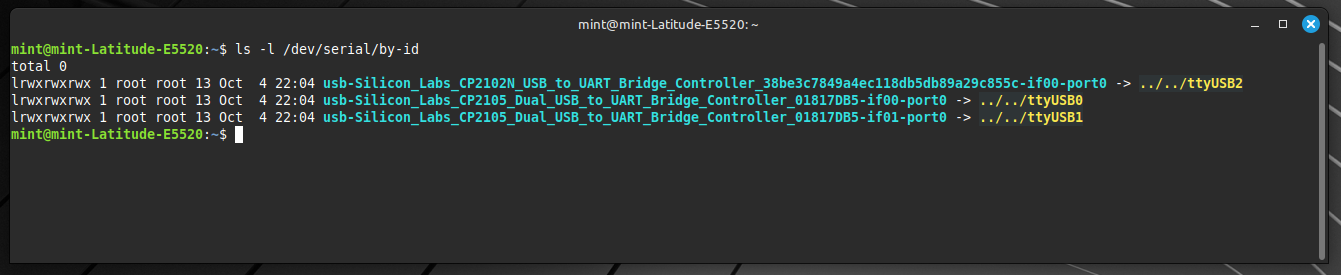

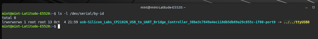

I, too, am new to Linux Mint & 73 Linux with my FT-891 and DigiRig Mobile.
I’ve been operating successfully on Windows 10, but, well, ya’ know… I don’t know what ports to set for CAT or PTT for JS8Call or WSJT-x.
I think that I’ve tried all combinations of the three ports that show when I ID ports in Linux Mint (see images). In some configurations, PTT sticks ON Transmit.
Thanks to anyone who can advise me. Coyote KO4UPH
