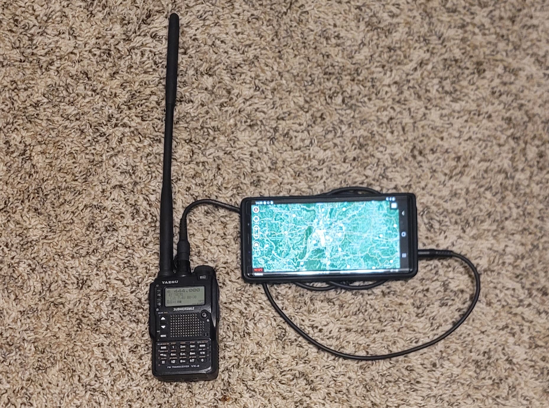

The ATAK Hammer plugin works with the Yaesu VX8-DR thanks to the digirig
Would you consider creating a video that outlines your complete setup.
I dont have the proper equipment to do a video, but I can take pictures, and I am absolutely willing to help you troubleshoot.
Thanks so much… pictures and a detailed rundown would be very helpful. What do I need to make this happen?
Much of it depends on your radio and its specific settings. I dont have any experience with your particular radio. But if its motorola based for the mic. pin out. Then you may be able to use motorola connections for your phone.
Troubleshooting update. I have two samsung note 9 phones, that are running slightly different firmware. (Different cell service providers) one works perfectly and the other does not. This is even after I fashed the firmware to force the update. Phones work perfectly otherwise. They both tx, its just the one that wont recognize the incoming signal.
i have a phone that does the same thing
:frowning:
using ft8cn, you can see the incoming signal on the spectrum display.
you can raise/lower the ‘waterfall’ color temp by raising/lowering the output volume of the radio.
the phone just never decodes any of the traffic.
(setup works fine on other devices)
weird. maybe audio phase twist (in the phone)?
Yeah, ive never been able to figure it out.

Ok I discovered something today while playing around. I always thought the sample rate should be kept low to make the signal easier to catch. I hade it at 10000 - 12000. I was wrong. Take the sample rate and push it up to 16000. All of my failure to copy array errors went away. Then it was just a matter of tuning the mic. gain, vox level, and phone, and radio volume. Again, start low and work your way up. Even the oddball phone that I couldnt get to work works now.
