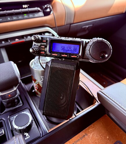

Looking to run FT8 on my 857D that’s remotely mounted behind the back seat in my truck.
