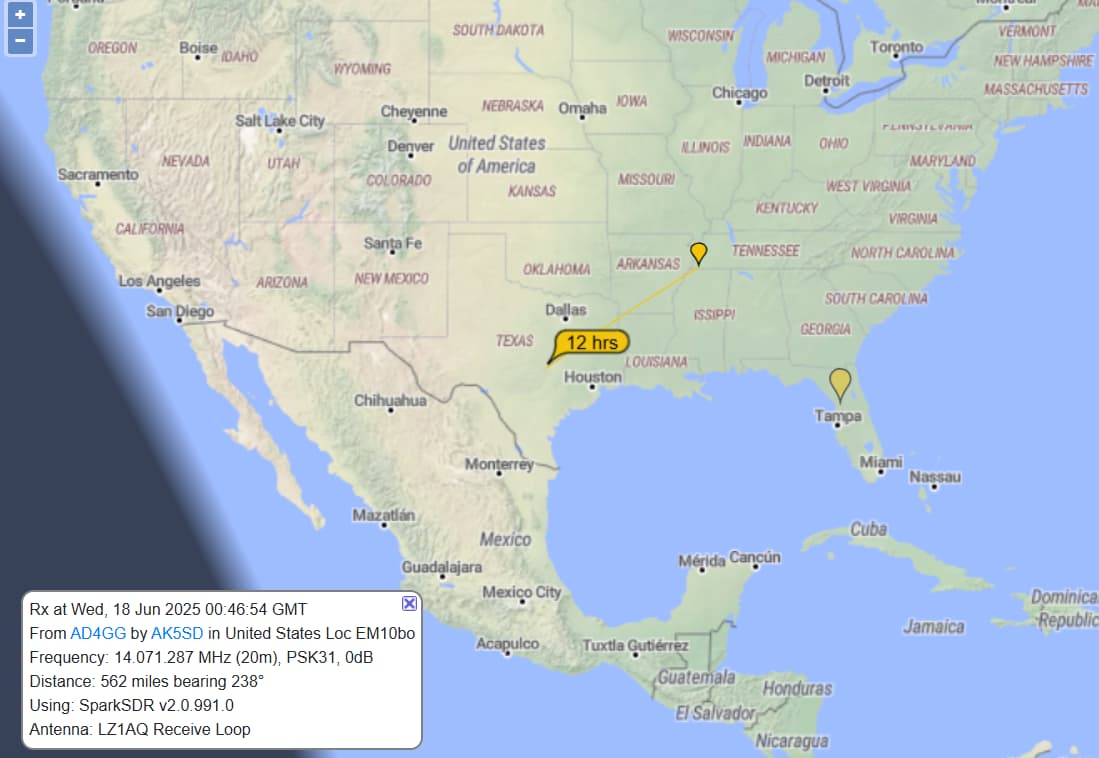

I didn’t check the ‘use separate port’ checkbox. Once I did that I was able to transmit. I did call CQ using RTTY and also PSK31 yesterday evening. Decoded some signals but not much PSK31 activity on 20 meters. I’ll keep trying, especially this weekend. I did see myself spotted on PSKReporter last night:
Thank you again - now I’ve got some new modes to explore!
