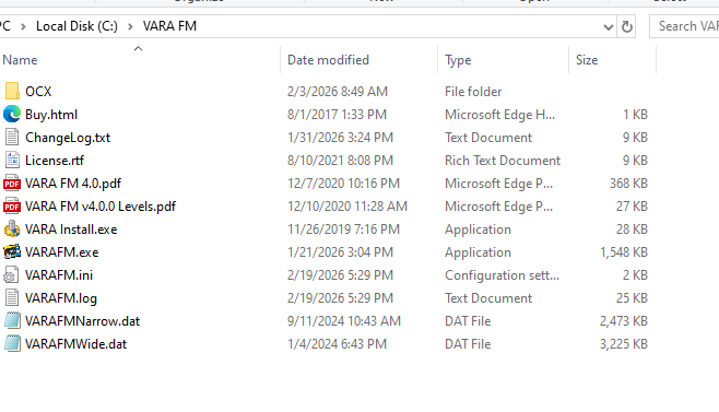

in your varafm folder, try renaming or deleting the varafm.ini file
then start up varafm
Which one?
you’ll need to uncheck the folder options box that says:
hide extensions for known file types
then you’ll see the .ini
most likely, it is the one named varafm and labeled ‘text document’

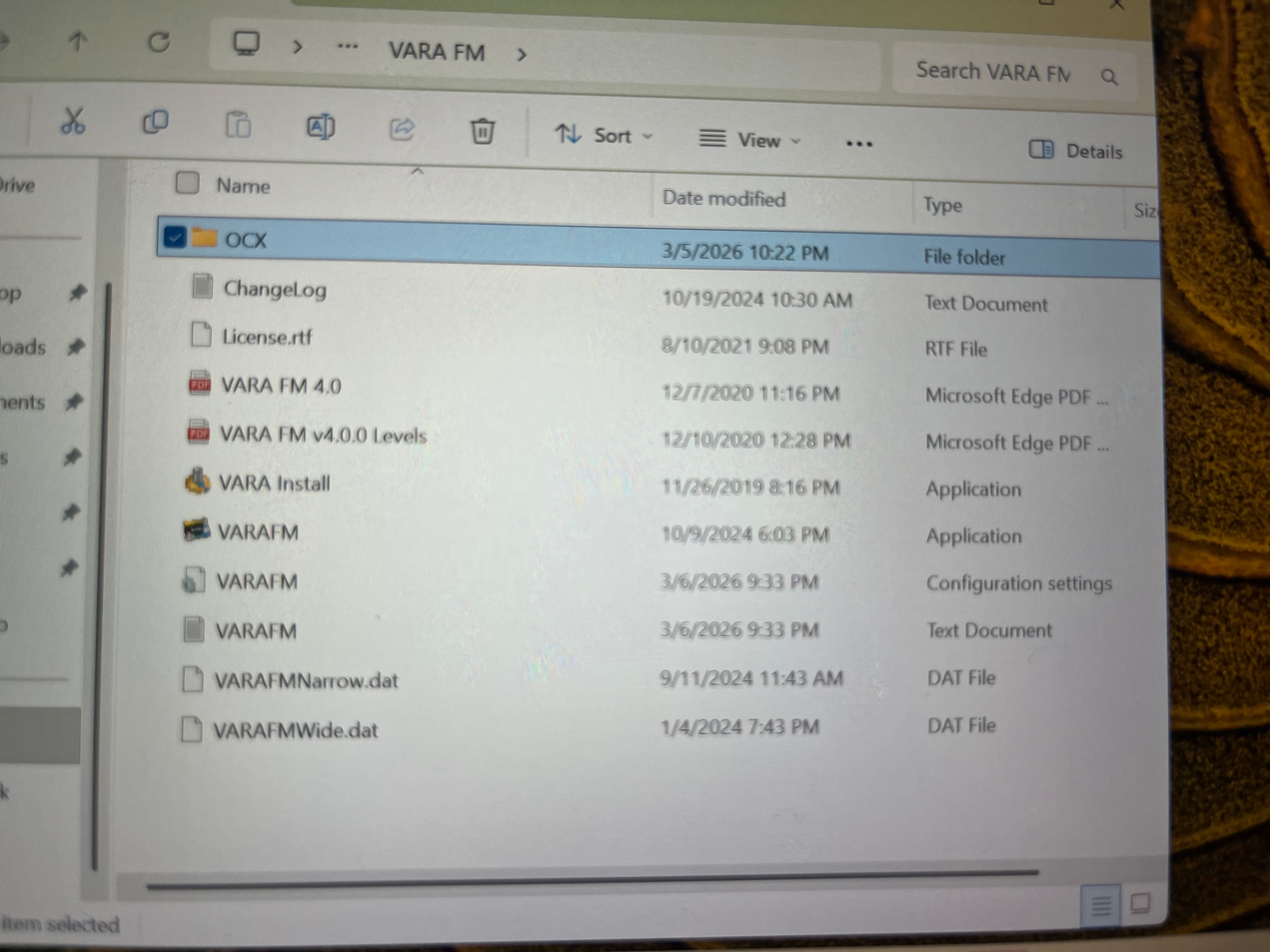

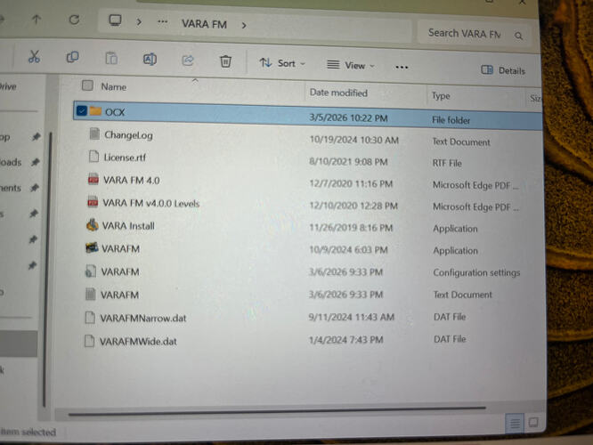

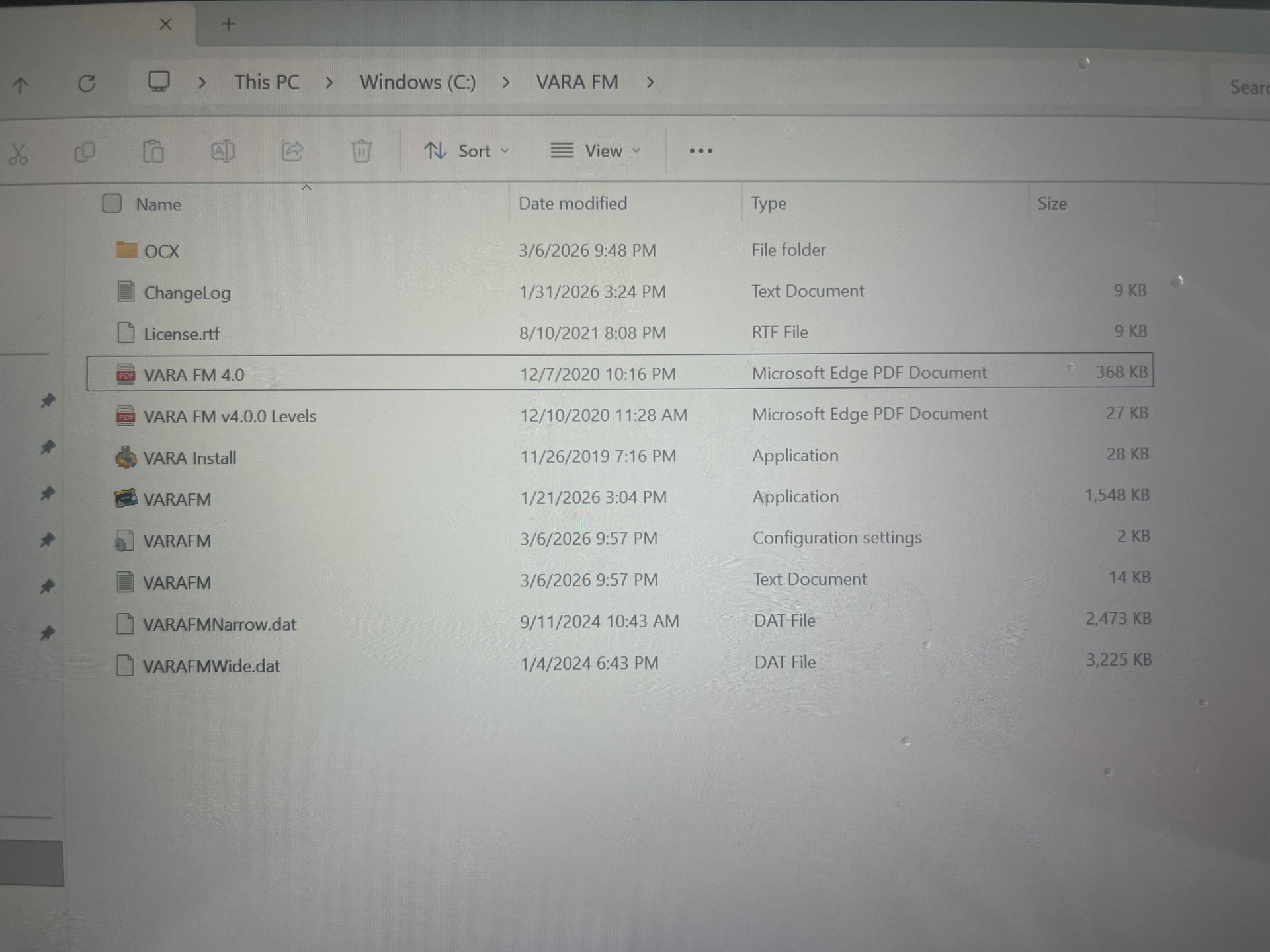

Checked the block to show hidden items.
No file labeled with the ending .ini
Deleted the varafm text document
problem remains, still freezes.
i’m sorry, i guessed wrong.
i cranked up the shack pc to look
looks like the file labeled configuration
i’m sorry i couldn’t help more, good luck
Holy crap I think it worked.
Thanks Homie​:folded_hands:
