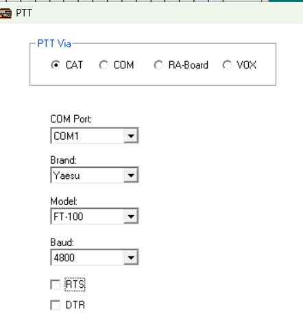

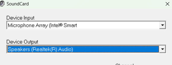

I plug the cable in, and there is no problem until I plug in the 88 Digirig, at which point a yellow caution sign appears. Therefore, I am unable to see the Radio or configure VARA FM. Without it, seeing the digirig, the port number is incorrect #_0001. I may have just got a quirkie digirig or the wrong one for the FTM 150 R.
I am running Windows 11 on an i7 laptop with 32 gig of ram—Treca, by Dynabook.
Thank you,
Don Jones, W5JX
(210) 374-1776
Unable to see Digirig and only get a yellow error when Digirig is plugged in. I have not made it to the Radio, yet. FTM-150R New
I had a similar issue… my Digirig did not appear in an com port - until I installed the latest driver. CP210x USB to UART Bridge VCP Drivers - Silicon Labs
