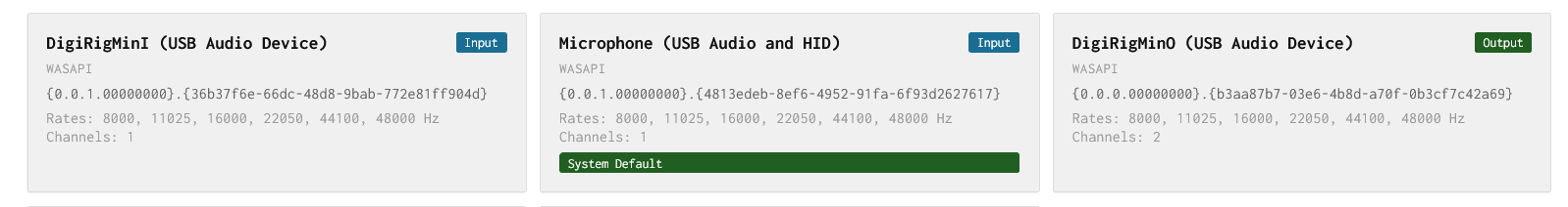

After windows software update Graywolf complains:
graywolf-modem: failed to resolve output device_id=5 ({0.0.0.00000000}.{949da259-73e1-4879-b619-f046120ec229}): output device not found: {0.0.0.00000000}.{949da259-73e1-4879-b619-f046120ec229}
graywolf-modem: start_audio failed: input device not found: {0.0.1.00000000}.{eaa384e6-2f7c-4501-a534-a63b6a7d3b01}

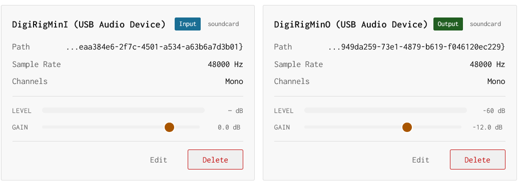

Config before update:
After update:
Note the internal id’s have changed. I now have to delete the old channel, create a new one with the “new” devices.
Actually, just figured out I can “edit” the channel, so it’s only about half as bad, but still sucks.
