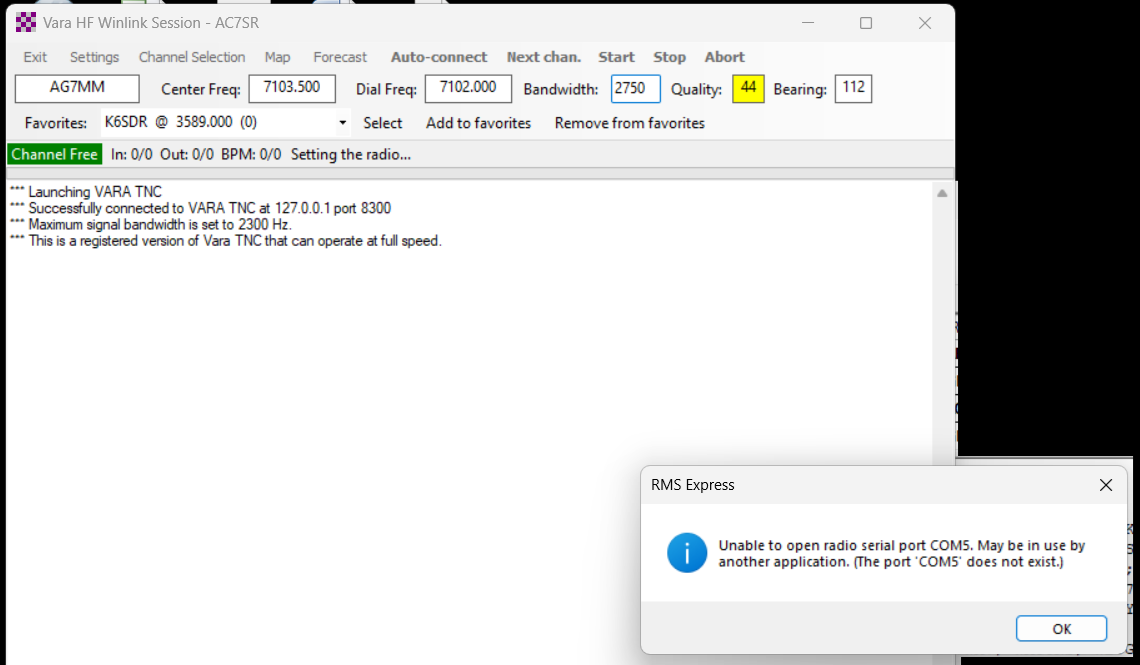

Winlink unable to open serial port
Trying to setup Digirig Mobile with Yaesu FT-857.
– Windows 11 upgraded from Windows 10 pro.
– Another laptop able to connect just fine.
– I’ve tried changing the port number
– I have no other software running needing ports
– The laptop sees the sound card and serial port.
– See the attached picture.
Your help would be appreciated.

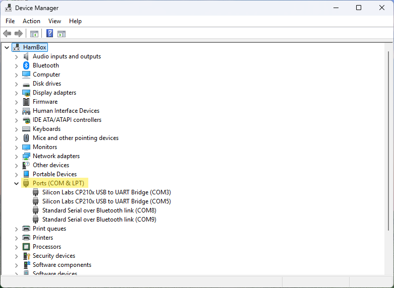

If you open the Windows Device Manager, and open the Ports (COM & LPT), it will show you what items are attached to which COM ports. That should provide an avenue to diagnose the COM port conflict.
As an example, here are my COM port assignments:
One of the Silicon Labs is my IC-7300, the other is my DigiRig Mobile, and the remaining Bluetooths are my mouse and keyboard.
If you add or remove a physical USB device while the Device Manager is up, it’ll update the COM ports in real time, which should help you ID which device is which COM port, as the COM used will very likely be different from one computer to the next.
I hope that helps, and let me know if you need further assistance,
Steve VE7IIF
