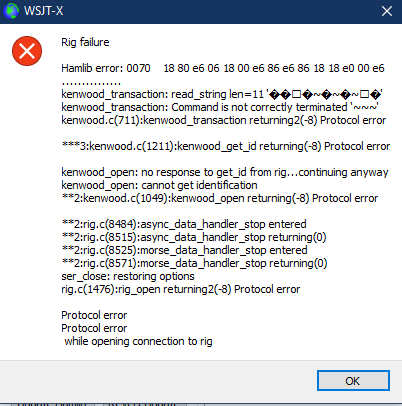

I bought all of my gear from Digirig so nothing would give me trouble. However, it can’t be easy and of course it doesnt work. I set my radio and have been through all of the online forum posts I can find about the issue and this radio but nothing has worked so here I am. Here is the error.
Receive seems to be funtioning fine. I have a Digirig Mobile.

Please check out this post for the settings and Digirig configuration that was confirmed as working by another operator:
Kenwood TS-450S “Test Cat” errors in WSJT-X - Digirig Forum
Thanks Denis. We spoke on the phone and you said default levels would not work and I needed the RS232 version of digirig, which I ordered. I’ll use the settings you showed with the new digirig and that should take care of things.
