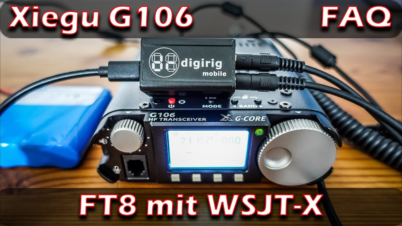

Xiegu G106 SDR HF Transceive to digirig How do I do it? Thank you very much.
For your Xiegu you’ll need:
- Digirig Mobile (logic levels configuration): Digirig Mobile – digirig
- Transceiver side cables: Xiegu G90 Digirig Cables Set – digirig
- One of the USB cables: USB Cables – digirig
See if this tutorial helps with the settings (may need translated subtitles):
