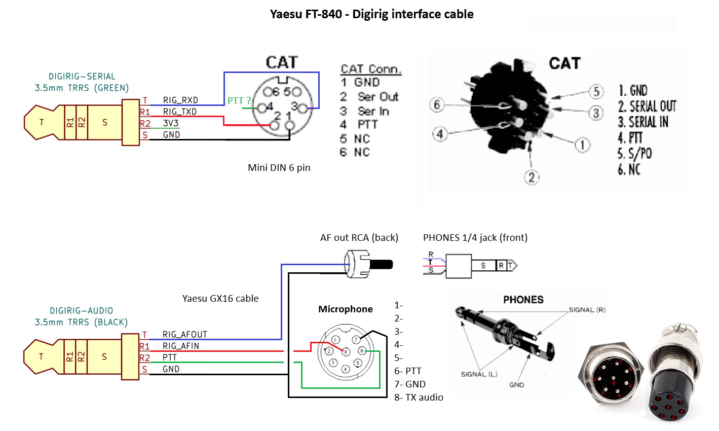

Hello, I made cables for interfacing Digirig with my Yaesu FT-840. It works Very well !
So, according to the digi-rig compatibility guide, they offer this audio-only cable. It is listed as a cable of last-resort.
So we still need cat control, as one is not listed. Thank you for providing a pin-out. I think I can re-cycle a PC PS/2 Keyboard or mouse cable to prototype one .
