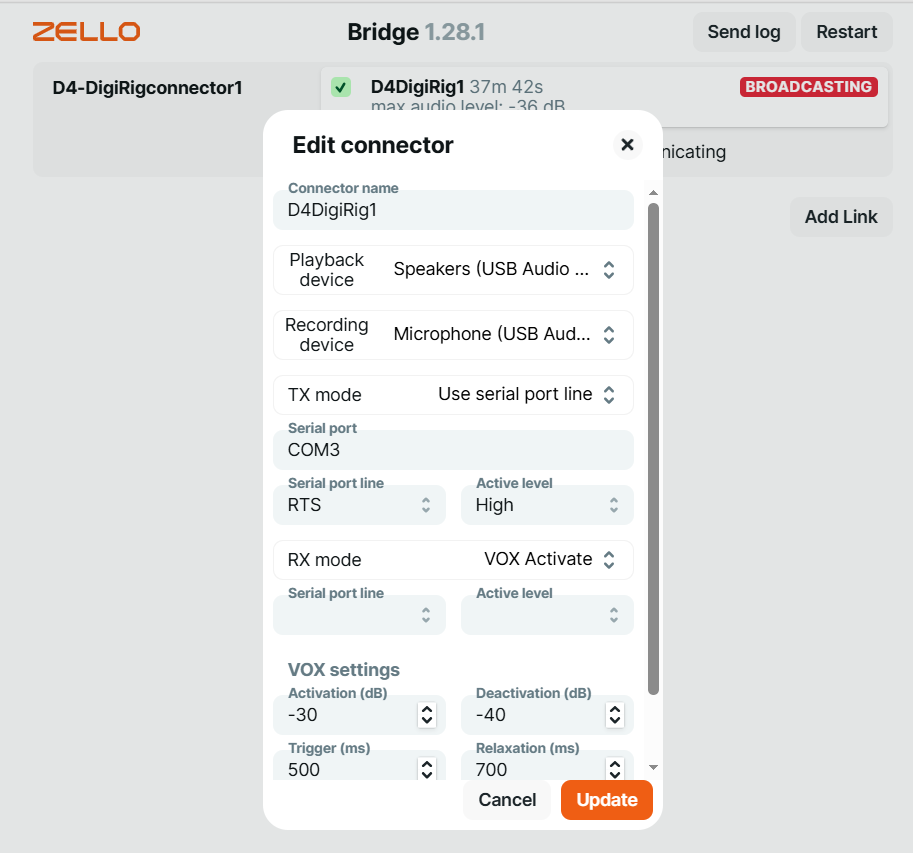

When I key up a radio TX via the I see the Yeasu receive the signal and the Zello Bridge " Max Audio level" change.
Here are my settings…
If I TX on the Zello App on my mobile phone, I can hear it on my second test mobile phone ( User #2), but nothing on via the radio and no change of audio level indication on the Zello Bridge (max audio level).
Any help with getting to the bottom of this is appreciated.
Settings.
