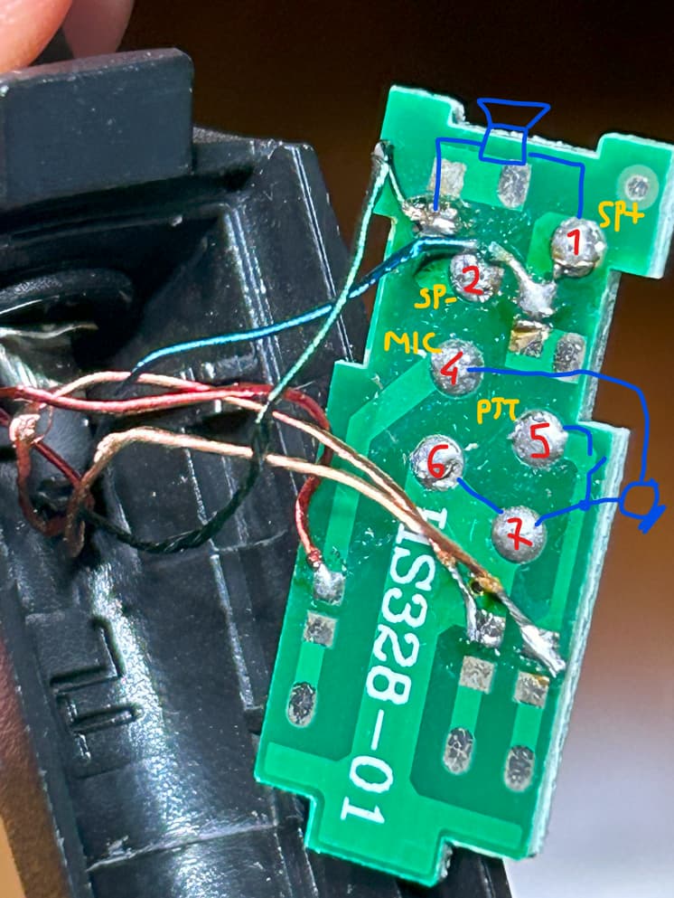

Currently there is no store cable for 13-pin Motorola style connector, but if you are open to a homebrew option, please check out this post:

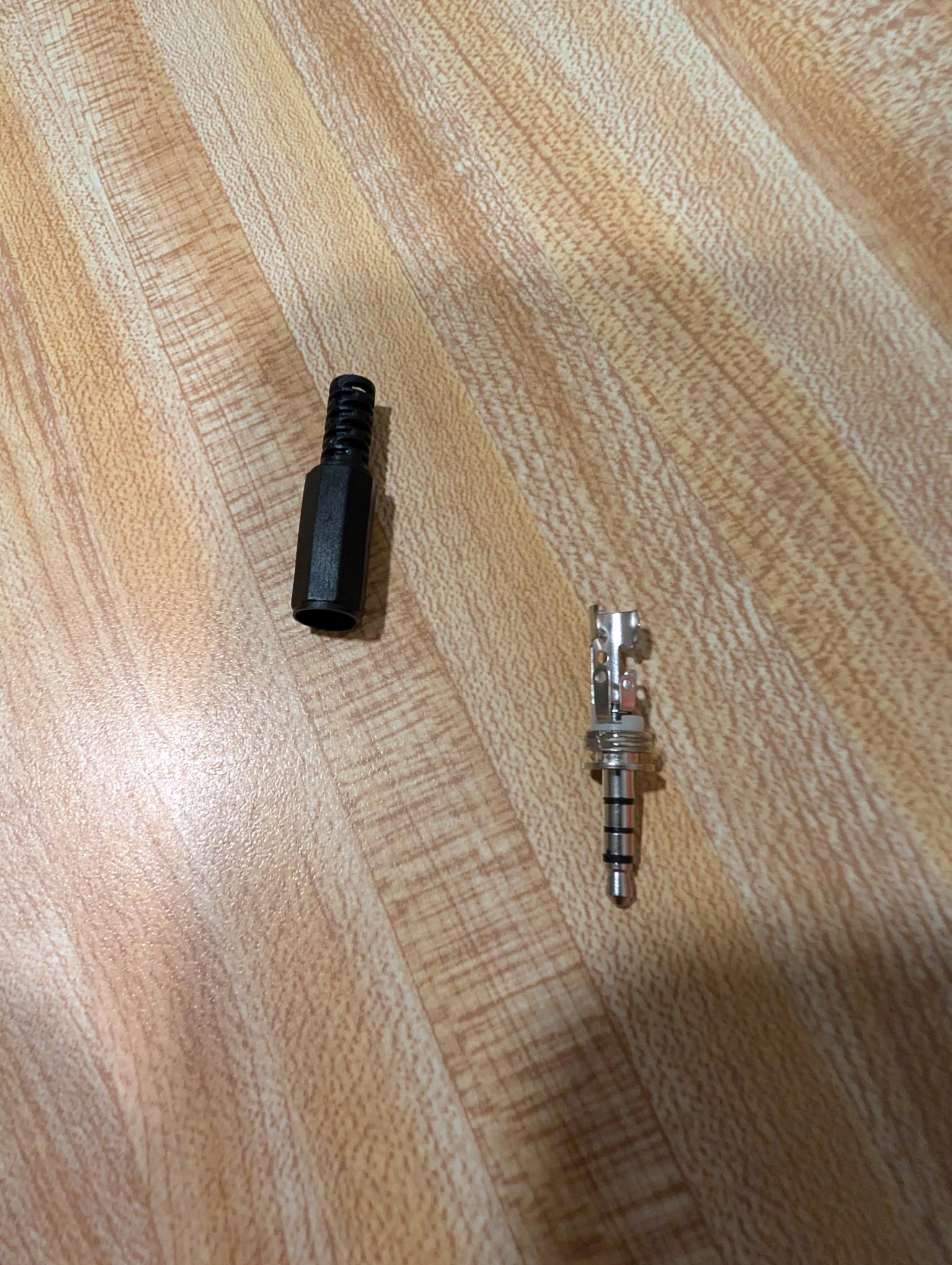

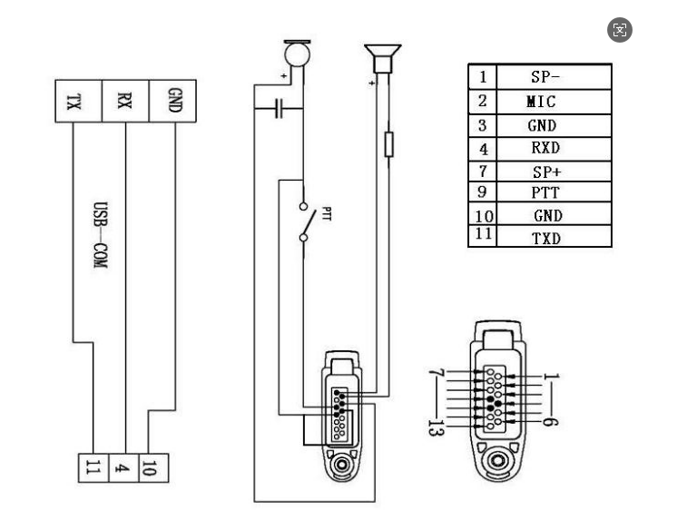

This is what was provided from retevis. Can you think of any reason to add any resistors? I also attached a picture of the TRRS audio connector I am trying to use.
The pin numbering convention in what Retevis provided is different, but if translated to what I posted in the linked thread the connections are the same. You should be fine without adding any resistors.
