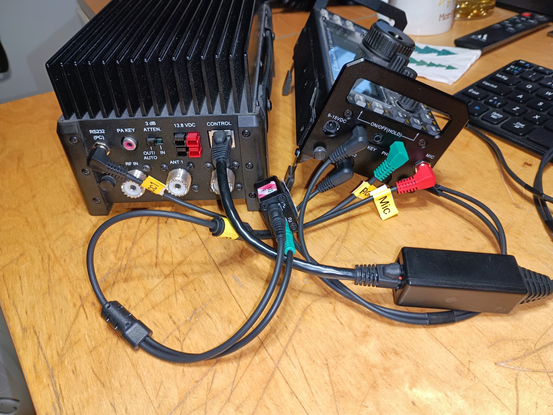

Is this the correct way to connect the KPA100 , KX3 and Digirig modem ?
Not turned on yet :smiling_face_with_sunglasses:
The black connector from the digirig (normaly connected to the kx3) now connected to the KPA100 RS232

Looks okay without getting my KX3/KPA100 out to configure for digital use. Sorry, I can’t find my notes on the routing of cables. Been using my Yaesu FT-891 this past year for digital portable.
KX1C
Hello Arne. Dave here (WD0HHU). I am trying to integrate my KX3 with the KPA100 & it appears that you have connected the black cable from ACC2 using the KX3 cable set over to the RS232 (PC) on the KPA100. Is this how you did this? 73s Dave (WD0HHU)
Try that setup . But it did not work …Any ideas ?
