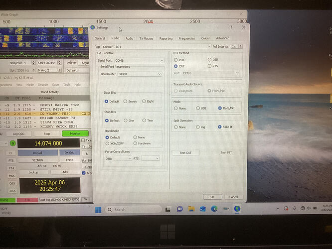

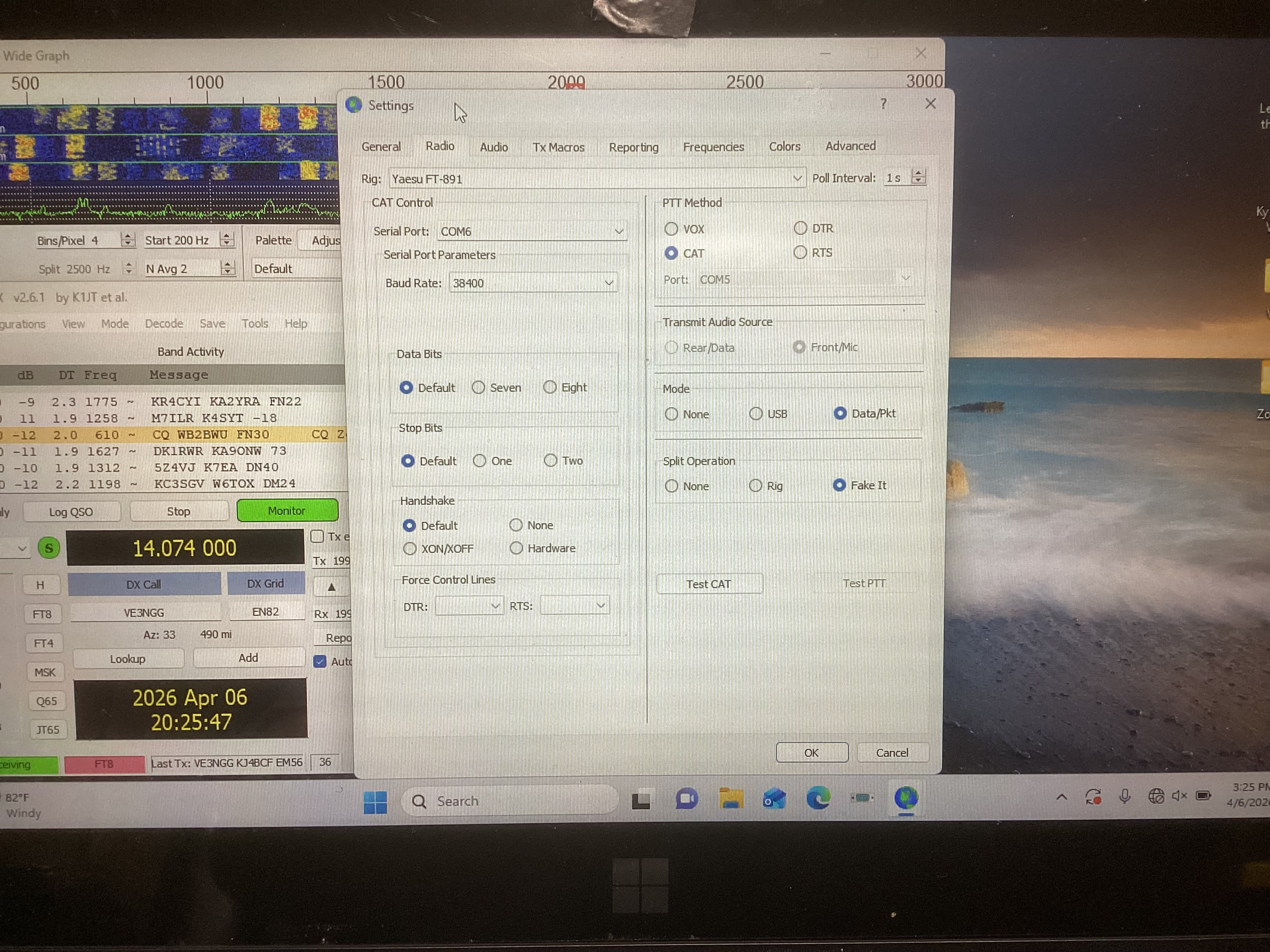

Let’s look at your WSJT-X configuration. Can you please share the screenshot of the “radio” tab?

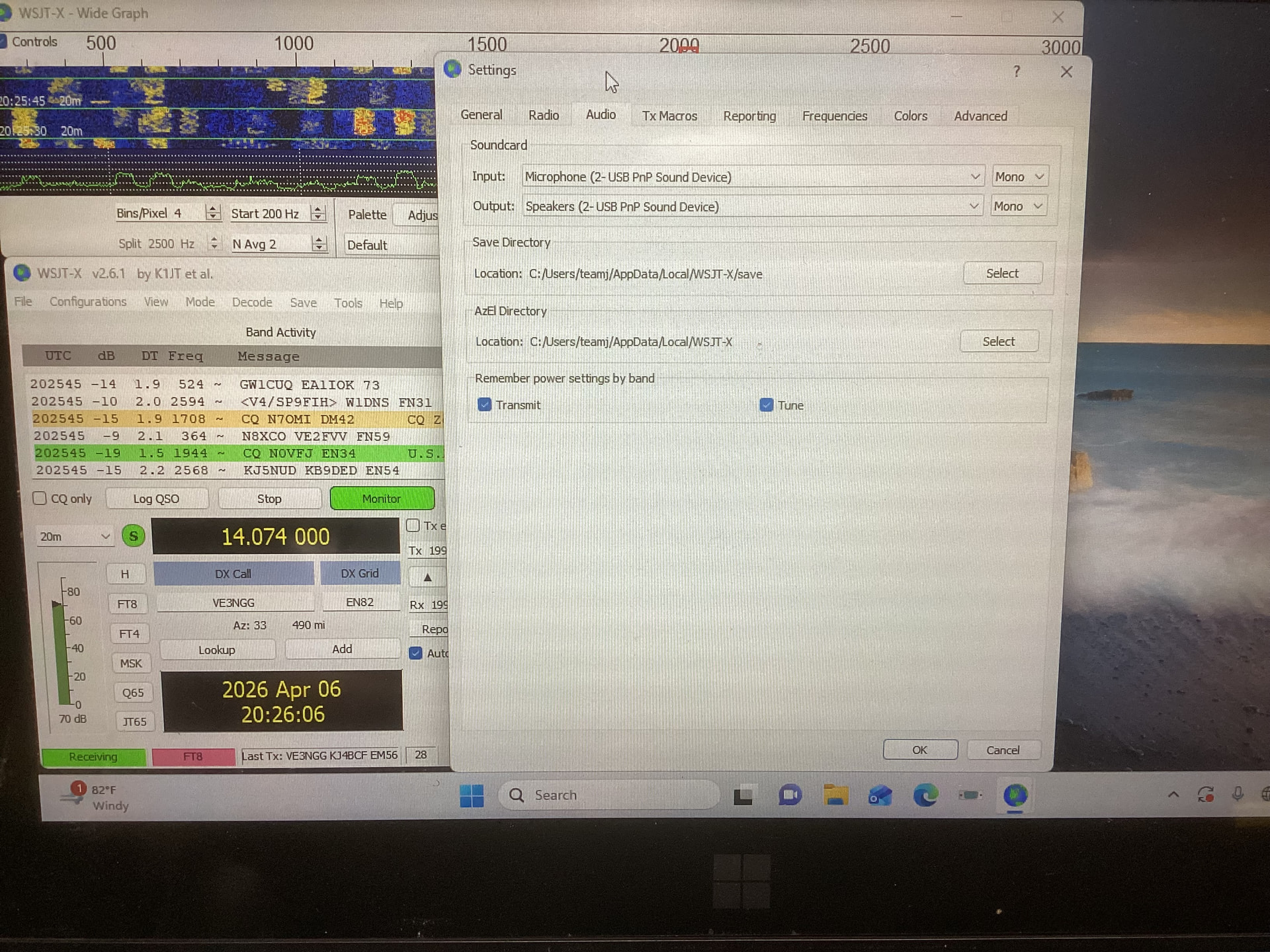

Here are the current wsjt-x settings.

Not likely RFI related then. Per your configuration PTT is handled via the serial commands over CAT control. This includes the start and end of the transmission. The abrupt end to transmission is either to a serial command issued prematurely from the software (unlikely) or radio ending transmission on its own.
Let’s try following:
  1. drop baud rate of CAT to 9600 both in WSJT-X and radio’s menus - this was recommendation from the setup tutorial
  2. confirm all other prescribed transceiver settings
  3. see if radio holds transmit as expected while using PTT test or tune feature in WSJT-X
