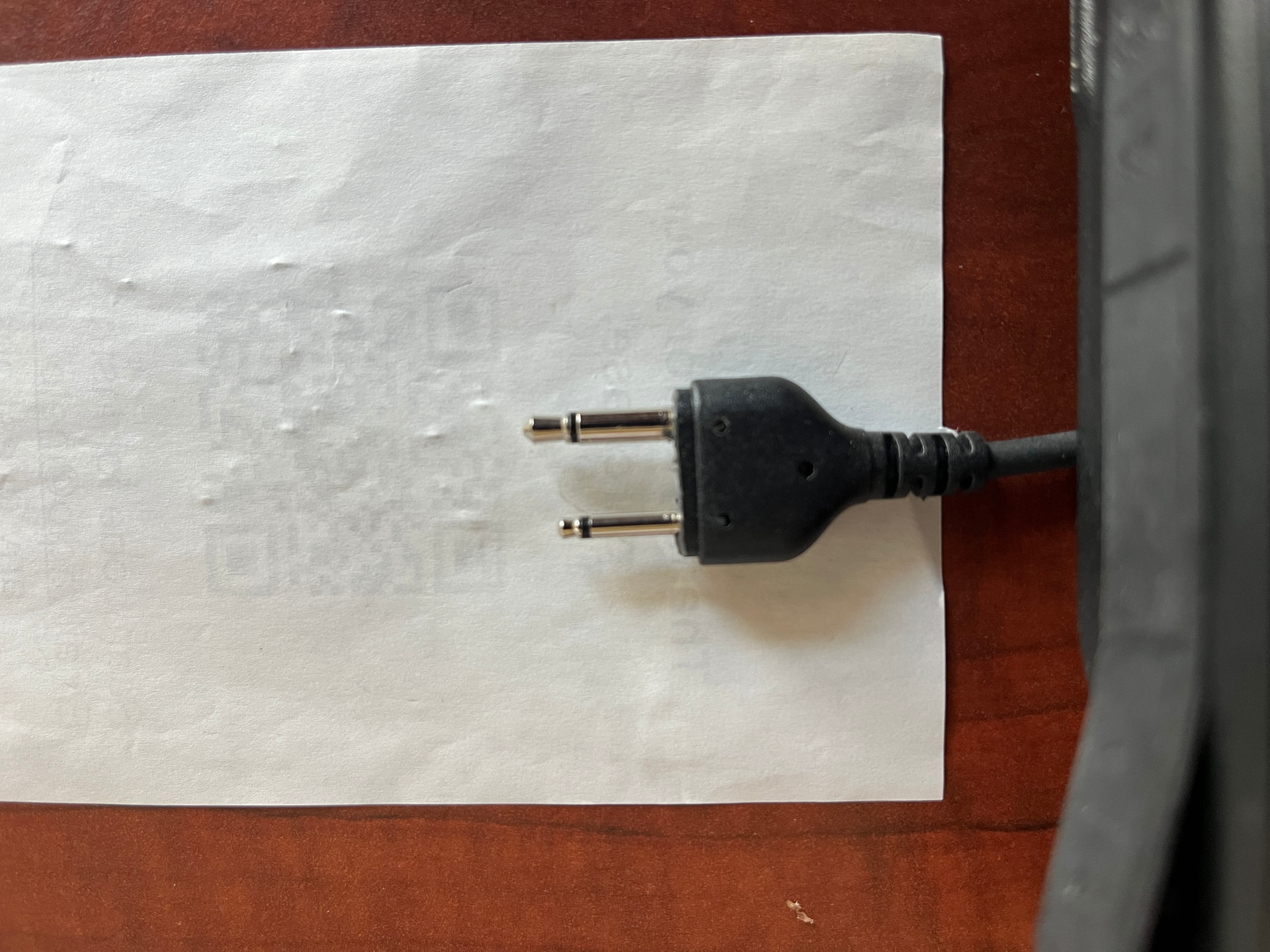

I tried trimming off about 1/16”. It only made it worse. Now the plug will not stay in. It backs out a bit. I tried using a 1/4” wide rubber band around the plug and the HT. That doesn’t quite do it either. I still have to push the plug in. In the process it changes the frequency, to some other than the target frequency. Annoying. Some pins in the HT must be getting shorted as I push.
I don’t dare trimming off any more as I see some gray epoxy between the pins.

That does not do me any good. By trimming the base of the plug, I have made the connection worse. This cable is now useless.

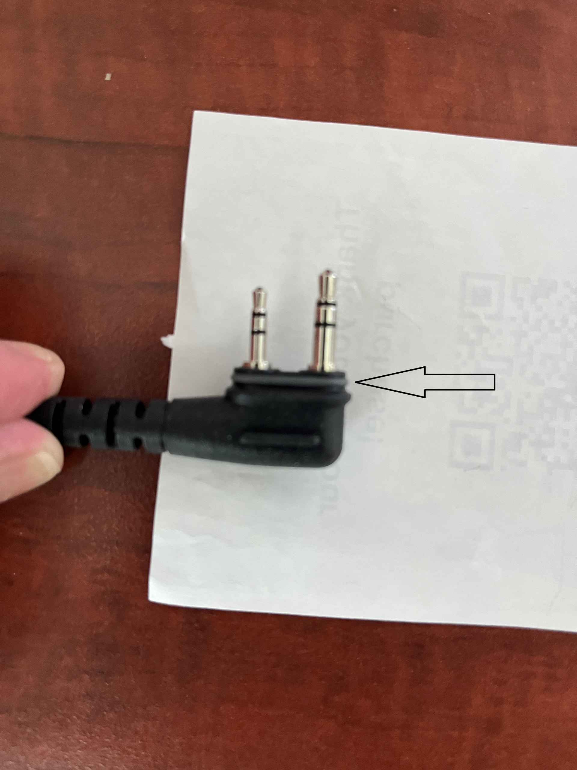

Both the Mobilinkd TNC4 cable and the Icom HM-186LS have rubber “gaskets” around the base of the plug. I think this is what HOLDS the plug in place. The attached photo shows the gray “gasket/gromet”.

I plan to try my own “gasket” using orthodontic elastic dental rubber bands. I figured I could cut a shallow channel in the base as in the Icom mic plug. A touch of super glue might hold it in place.
