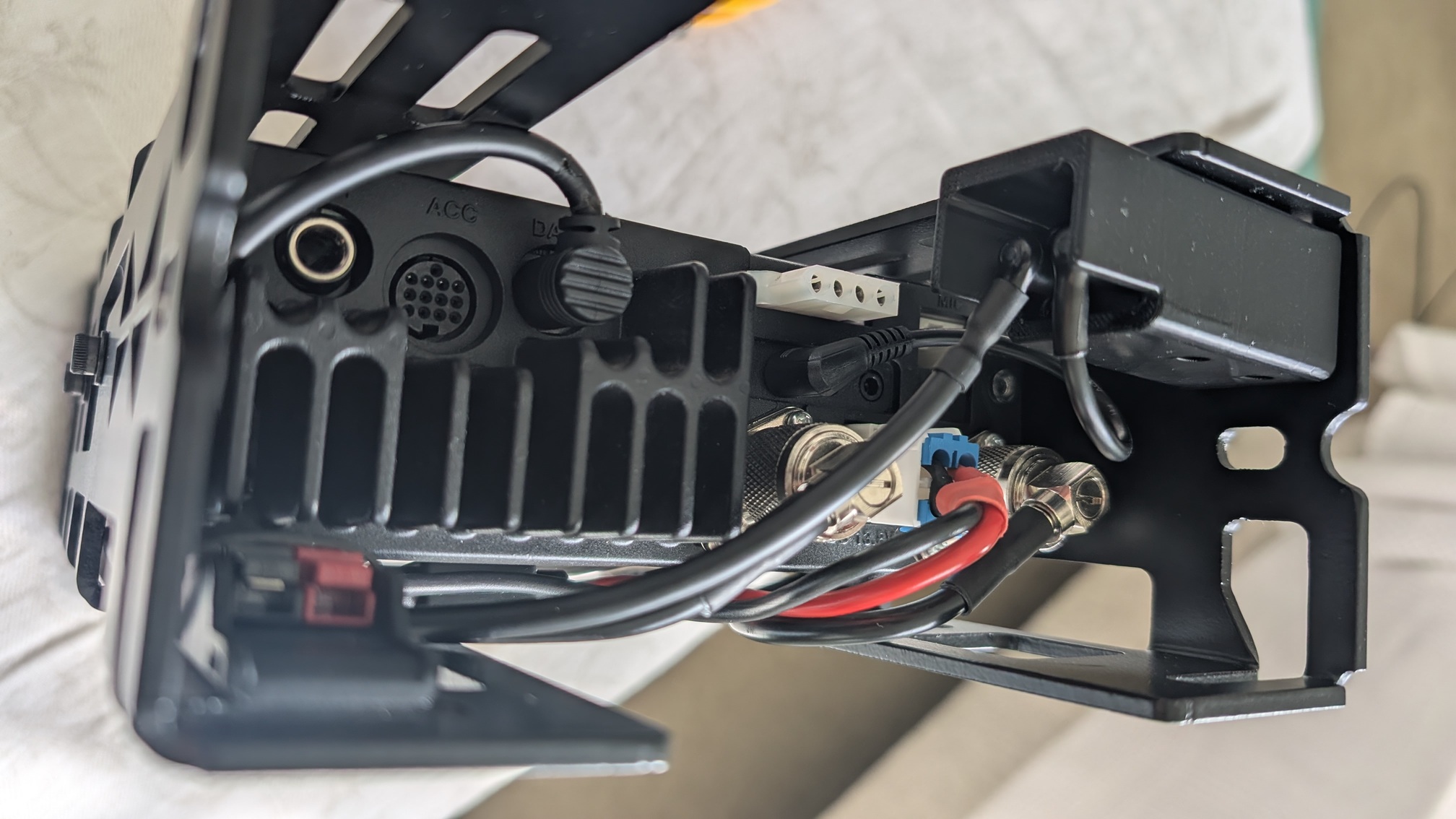

For those who may be running an IC-7000 with a DigiRig Mobile, here is the final result for clearing up space using a trimmed 6 pin DIN Data jack and a TRS/TRRS CI-V CAT cable.
The intent was to have any jacks/cabling be as protected as possible within the Armorloq cage, hence the use of 90 degree terminations.
Thanks again to @Robert_Mehrer for providing his custom DRM case to the project, and @K0TX for sharing the wiring schematics for his excellent products.
