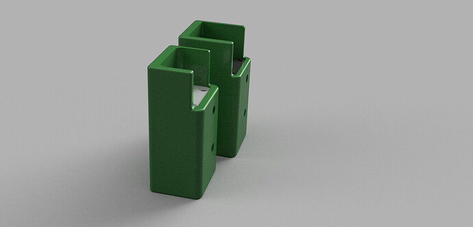

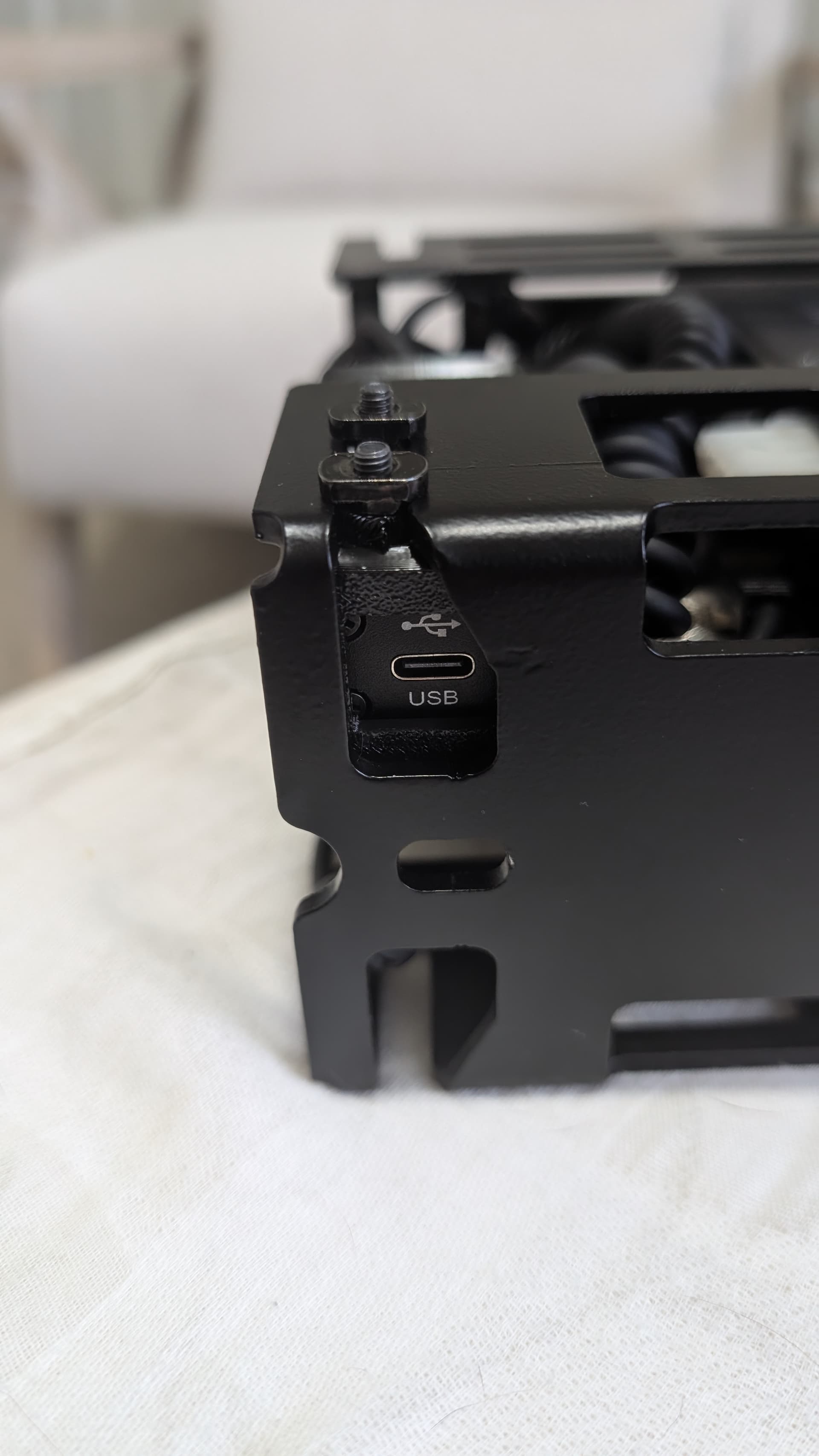

Does this piece fit on the new, smaller DR Mobile case, or is it only for the older, larger case? I love the ability to secure it to my IC-7000 Armoloq case.
Thanks,
Steve VE7IIF
It’s for the older (square profile) one.

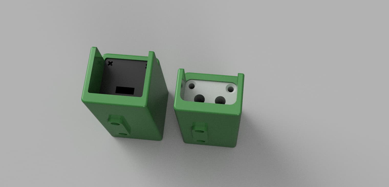

If theres a new model can some one send me the specs and ill redesign or update this. Shouldnt take me long.
Do you have the specs on the new one? I dont have the new style, ill go ahead and update the design
Which style were you wanting to fit? The green one or the hard case one ?
go to the thingiverse post
There’s hardly any empty space in the new model, so same approach may not work as well.

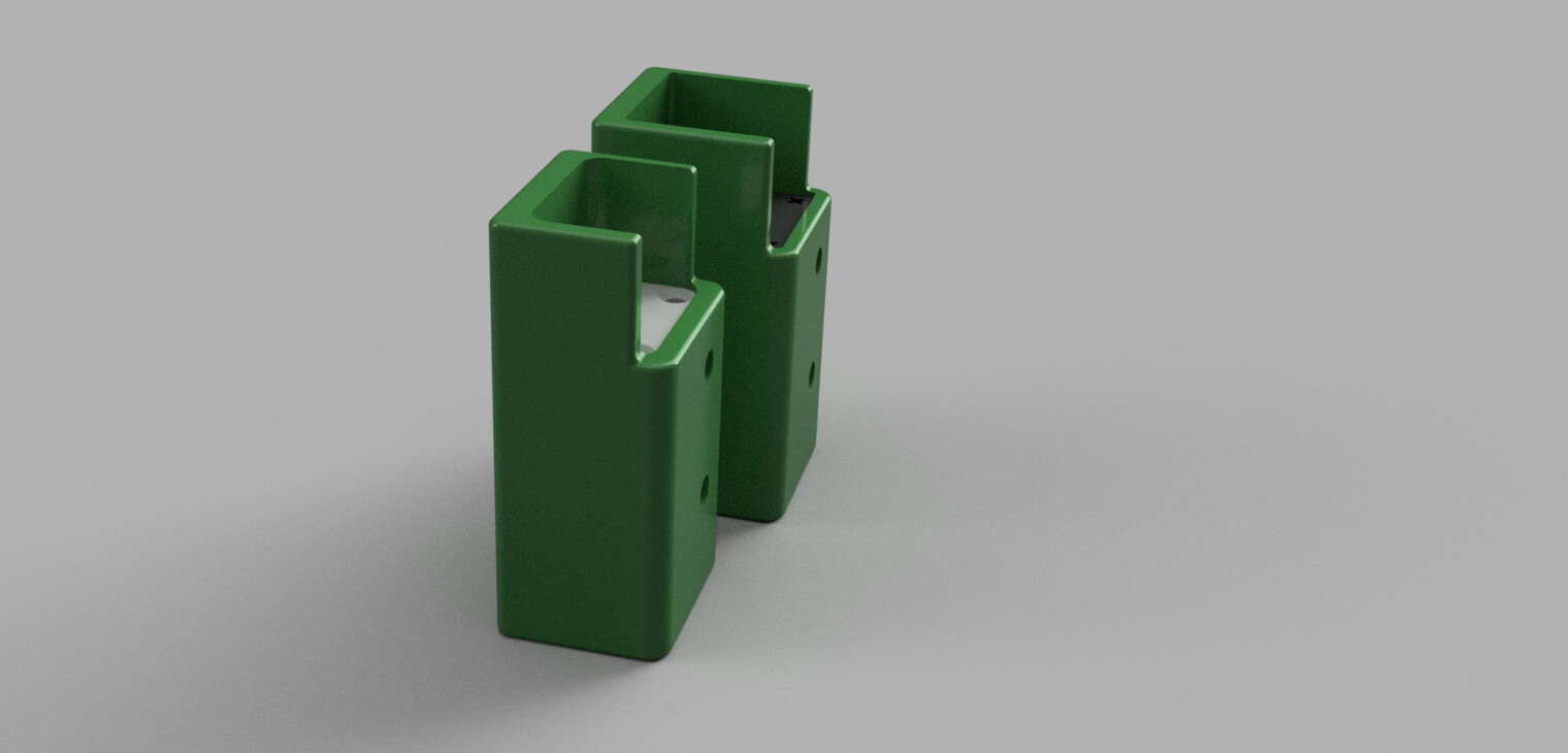

Here are the STLs if you want to design a new mount:
do you have these in the cad versions? I can import STL into fusion but its not as precise, these have hollows and voids that aren’t filling correctly. or if you have the profile link or source i can pull the cad from them.
I can do STEP file if that is a better option for what you are using.
yes step is much easier, STLS dont have measurements just plot points for a printer, trying to convert an STL into a solid with sizes is a pain.
I’ve uploaded the STEP files as well. Hopefully that helps.

OK that was a quick and easy redesign, ill have the new case uploaded to the thingiverse page shortly.
Edit file has been uploaded as the mini

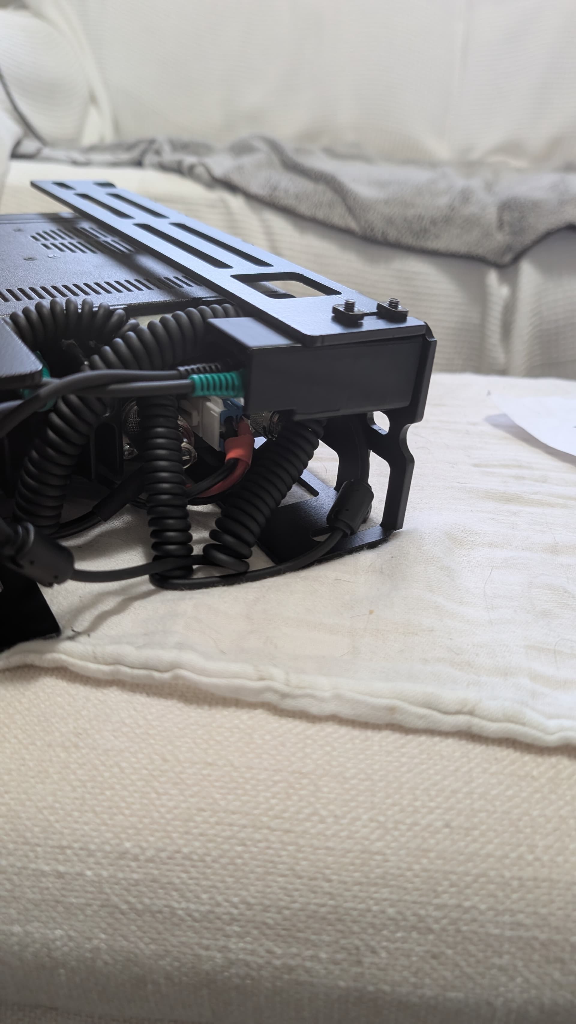

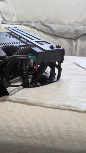

I did the print in TPU 90A yesterday, and it turned out well.
I spent a better part of the day learning how to the move the bolt positions of mount in the print to a slightly different location so I could fit it into the spot I wanted—this is all new to me so a steep learning curve, buy I’m enjoying it.
Next, I’m going to modify the interface cables to be just long enough to go from the radio’s backplane jacks to the DR Mobile, to clean up the clutter.
Thanks again @Robert_Mehrer for your file and assistance.
