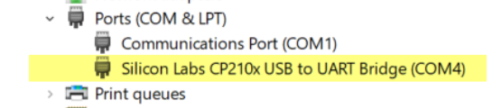

Standard + Enhanced ports is something you’d see with Yaesu FT-891.
There is only one port that comes from Digirig Mobile and it doesn’t contain “standard” or “enhanced” in the description. It should look like this:
Please confirm.
