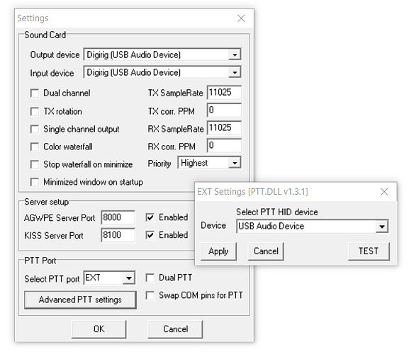

In case of ID-5100 you’ll need to configured PTT by GPIO3. In soundmodem this method is called EXT.
OK Great! I’ve downloaded the PTT.DLL from UZ7HO Personal page - Packet-Radio - English version and placed that inside the same folder as soundmodem.exe and it is working find , downloading winlink emails right now.
