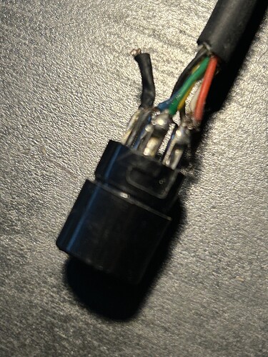

Question: I have had the microphone cable pull out if the mic connector. I do know the mic jack poinout but what I need is the mic cable color code in order to re-solder. Multiple wires broke off of the connector. I have reached out to QYT on several occasioins but have not received a reply. ASny info would be greatly appreciated.
Thanks,
N3JZE

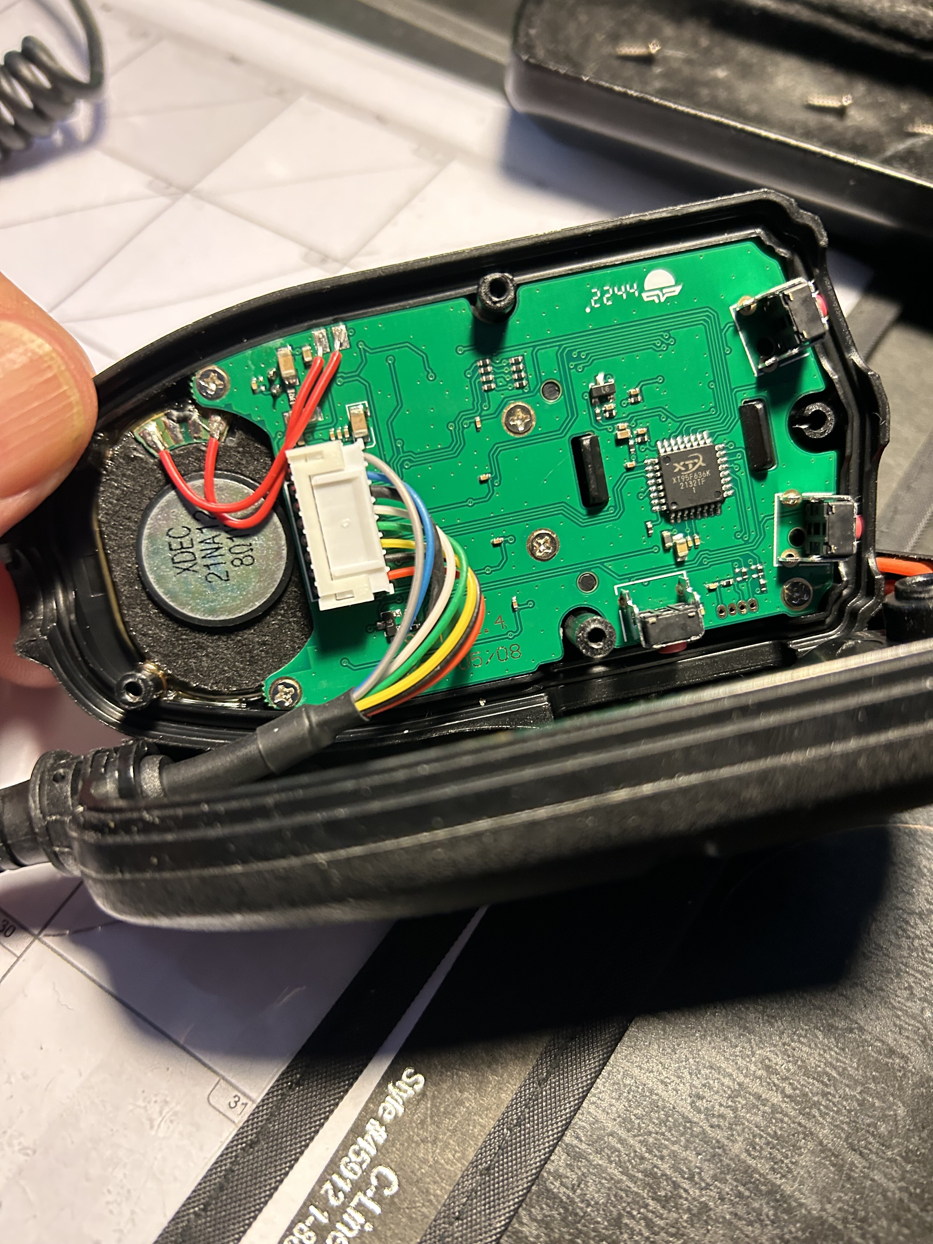

Color coding is not always reliable, confirming connections with a continuity tester is a better option. If you need help figuring out the signals, post pictures of both sides of the mic’s board and we’ll try determine the wiring.
Thank you for your response. I have attached two photos for reference. Inside the microphone is a molex-type connector onto the circuit board. At this time I have not taken the circuit board out of the microphone housing to trace out the circuits. I was hoping to purchase a replacement cable, match the colors on my original cable, repair, and use the original as a spare. Unfortunately I have been unsuccessful in obtaining a replacement cable. I was a bit disappointed that there wasn’t better strain relief clamping on the mic cable connector.

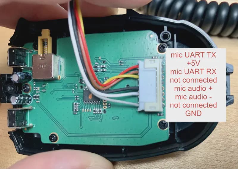

The PCB doesn’t show any markings, there may be some silkscreen print on the back side that could help identify the signals. I did google lens search and it came up with this among the results:
May be a similar color scheme if you want to trust it.
Thanks. The photo you sent is quite different mainly due to not only audio. PTT, and up.down buttons, but has additional functions since the microphone is also the control head.
I will need to possibly trace out the circuit board.
