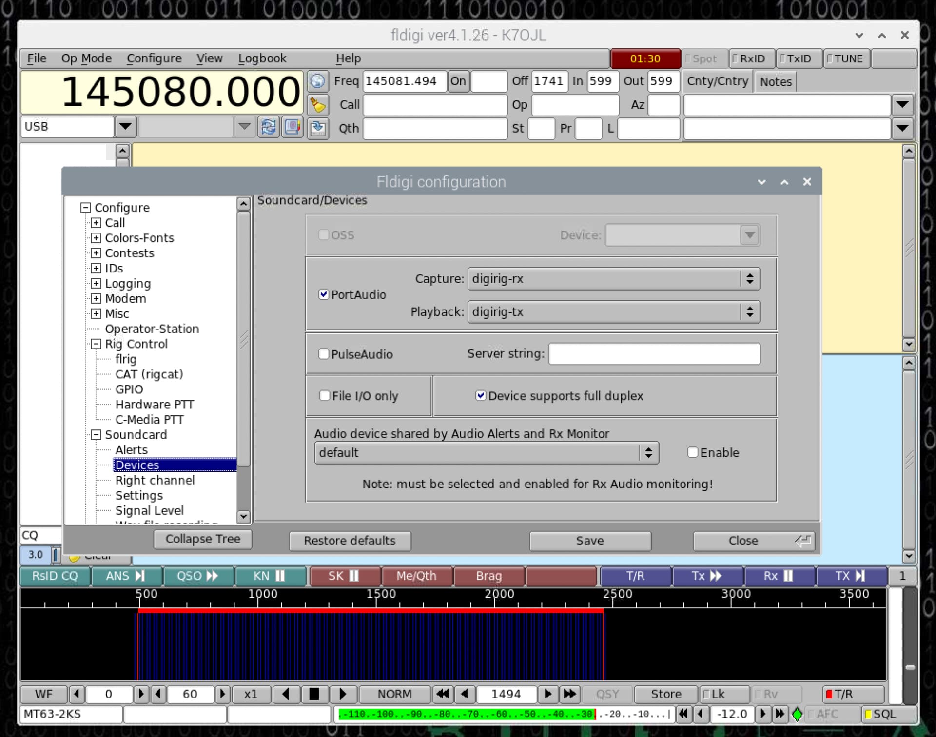

Go to your terminal window and type alsamixer. Select digirig in the f6 menu. Select f5 to look at all settings. Move sliders so that everything is as close to zero db as possible. Select auto gain control and click m to mute it. Close alsamixer and type sudo alsactl store. Then exit terminal.
Turn squelch on your radio to zero and tune the volume knob until the colored diamond indicator at the bottom of the FLDIGI screen turns yellow, then back it down until it just barely turns solidly green. The setting at the bottom that currently says ā-12ā is an attenuator that can be increased to zero.
