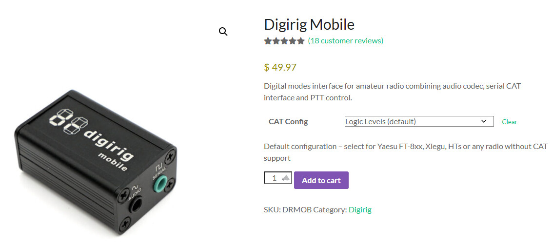

I have already bought the Digirig Mobile and I believe it was for FT-891. Which one will work with the G90?

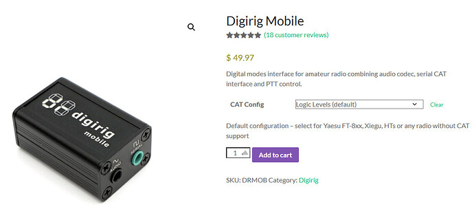

For G90 the best kit includes:
Additionally, check out power cables available for your Xiegu radio: https://digirig.net/product-category/cables/power-cables/
You can use Digirig DR-891 with your G90 - this will give you audio and PTT (equivalent functionality of Digirig Lite). With this arrangement you can achieve serial CAT control by connecting Xiegu’s native blue dongle between the additional USB port on your computer and G90’s head unit.

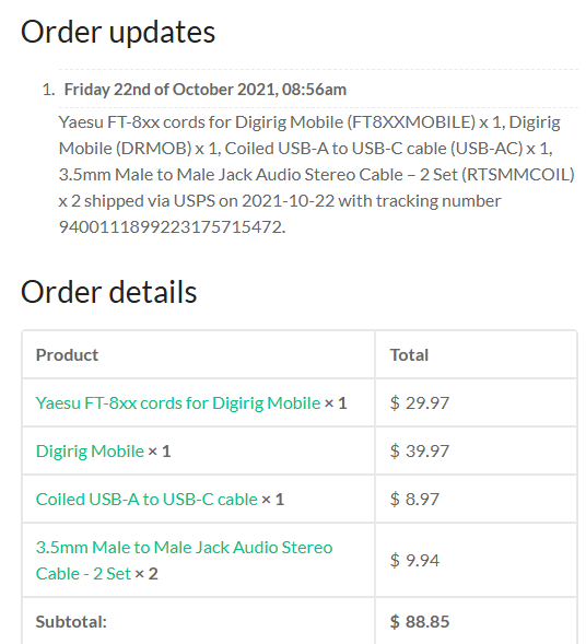

In 2021, I bought but never used this one (intended to use with FT-891):
The Digirig in your new order is the similar functionality as the one you got in 2021. You can use either of the two with G90 or FT-891.
There is now a specialized version of interface for FT-891, the difference is that it allows to have a complete integration with the computer via a single USB connection - something that requires two connections with the regular Digirig Mobile. More on that here:
