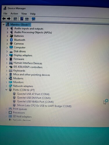

I tried setting up with WSJT-X but to no avail. I checked the serial cable with PuTTY and it doesn’t look like it’s working.
I’ve attached a picture

Can you share the screenshot of the device manager showing COM5?

I don’t have a COM5. My digirig is COM8.
Ben,
My bad, that looked like COM5 in low resolution, now I see it’s COM8.
